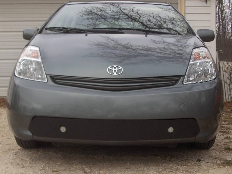

    Its recommended to remove most or all grill blocking in the summer, especially if you don't have instrumentation. The bra likely won't cover the grill openings. Wouldn't be good for business if your product toasted cars in Phoenix.
    Here's a picture of the lower grill block I have on my Gen2. Plastic cut from the back of a dead TV and zip tied to the grill. I've had it on the last couple months without a problem. Haven't done any long drives in 80F+ weather, though.

    Sorry but you are getting some bad advice here.
    The block heater is not a bad idea IF......you live in a really cold area and your car sleeps outside. It will NOT make a significant difference in your total gas mileage, however, unless you make a lot of short trips starting and ending at home......in cold weather.
    Grill blocking can be dangerous if not done right and gains you little or nothing below about 30 MPH and not a lot above that.
    Done wrong, it can even make the wind drag worse.

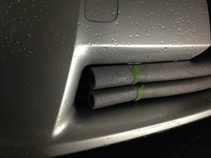

    Grill blocking is another tactic, assumes the grill opening is designed for worst case, hot summer driving, extended hill climbs. It's good to research it though, don't just completely block, and find out at what ambient temperatures to block, or not. There's likely a zone of the grill that has the inverter radiator behind it, it's best to avoid blocking that zone. With horizontal slats on our grill, I use plumbing pipe foam insulation, the slitted kind, pushed onto the slats.
