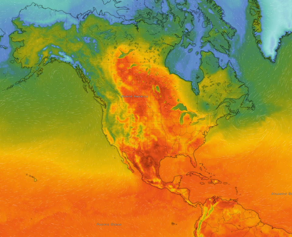

    I think I took a screenshot of the US in subzero temps from 5 years ago. I'm trying to look for it. It was showing -10f in some areas. A big chunk of the US was frozen. Some as far low as Texas.

    You know it cycles, right?????

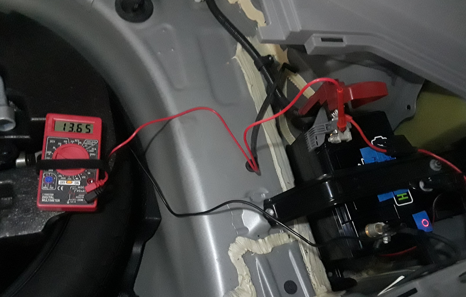

    Switched to the new 12v battery so far everything seems normal. Will observe for much longer. But I think it should be Ok.
    After 2 months of sitting around after a full charge, it connected to the car at 13.65v.

    That's what I like about mine. I can run my amateur radios on it, up to some 20A or more, and the voltage doesn't hardly dip. And I also don't have to worry that much about running out of juice and not being able to start the car.
