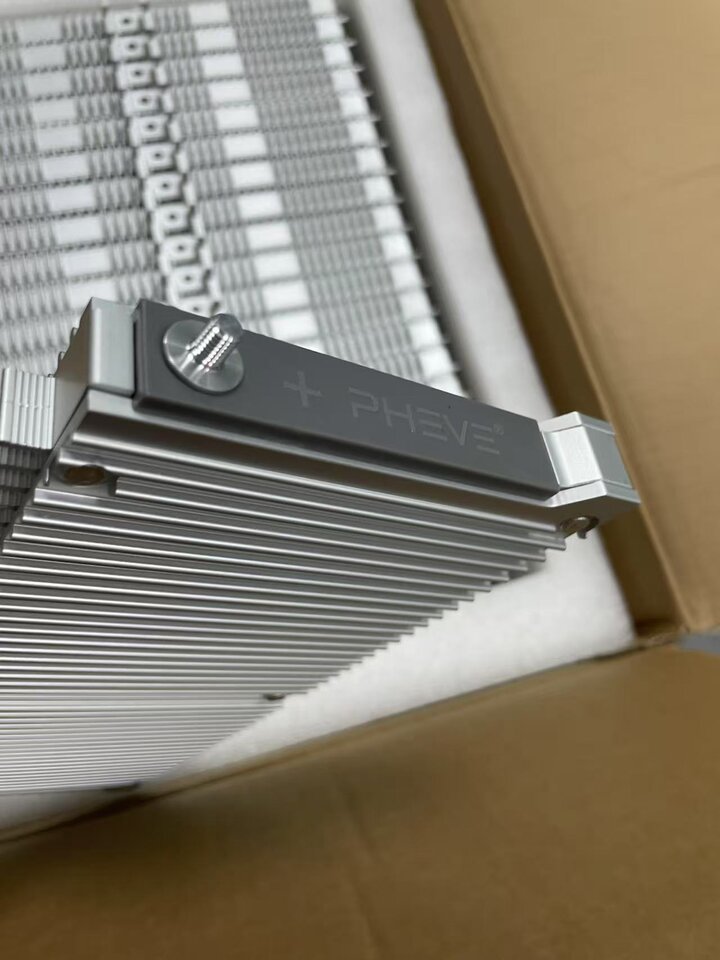

  17. Roco1993
    Roco1993 New Member
    May 15, 2025
    Hong Kong
    Hi mudder, I left the comment on your youtube video by the username CharSiu. I know the designer of this kind of battery. As you said in the video, he did aware the insulation problem on terminals, so he used plastics in later versions.
    But Huilian and some other manufacturers are not aware on this. I can even show his patent certificate to you and can even share more details on it. I am new to PriusChat and I am not sure how to send a private message. Please contact me.
    regard,
    Roco.
  18. mudder
    mudder Active Member
    Mar 13, 2024
    305
    414
    Chattanooga, TN
    He Roco, PM sent to discuss this further. Is the 'PHEVE' blade in your picture your engineer buddy's original design? Regardless, I'd love to review it if the innards are different from the Huilian module I reviewed last month.
