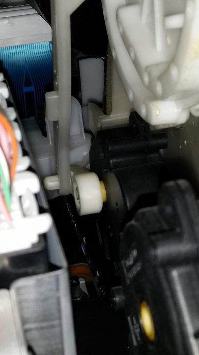

    Hi all. I am the original owner of a 2008 Prius, and am familiar with the various noises that the car likes to make. However, a new clicking noise has started recently, and I was hoping you guys can help identify the source/cause, so I can (hopefully) repair it myself, or have it repaired cost effectively.
    I have attached a pic of what I think is the source of the noise.
    This pic is looking upwards under the dash, above the brake pedal. In the center of the pic is a white thingamajig. This thing is attached to a motor on the right side (to the right of what I think is a yellow bearing or washer), and the other end is attached to a darker gray arm. When the climate control makes an adjustment, the motor turns, the white plastic piece turns, and the arm moves. What appears to happen is that sometimes, the motor continues to operate when it shouldn't, and these plastic pieces all kind of move around, clicking.
    Sometimes, the clicking is louder than what I was noticing today while replicating the issue.
    Can someone identify these parts, their purpose, what might be defective or need adjustment?
    Much appreciation in advance!
    Jeff

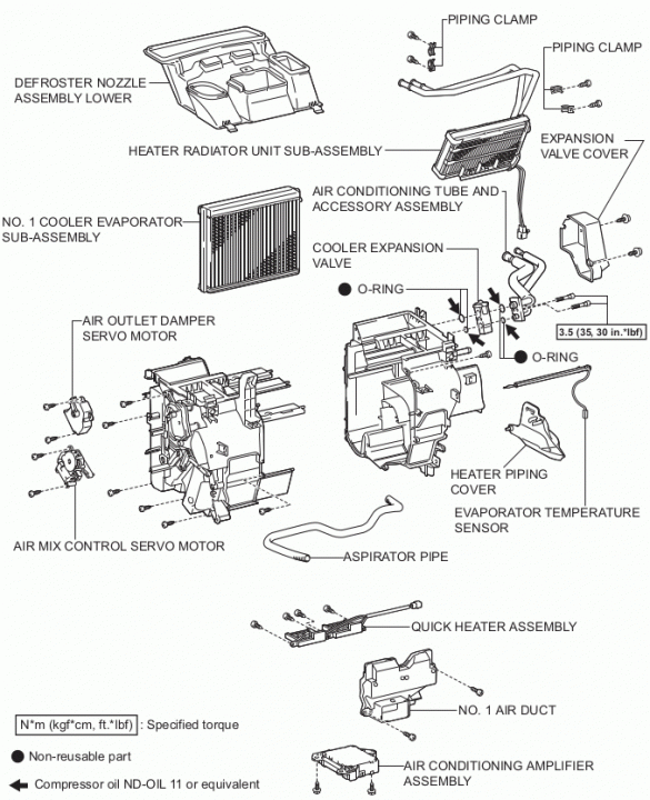

    From the diagram attached, it looks like "air outlet damper servo motor" is the likely name for your thingamajig. Or it could be the air mix control servo motor, not sure from the photo. To get to it for purposes of repair you will need to take apart the dash, which is covered in at least one place:
    http://techno-fandom.org/~hobbit/cars/chris-dragon-dash.pdf
    Probably a time consuming repair, although more fussy than difficult from the looks of it. It could be that the air damper is sticking for some reason, and the gears are grinding as a result. If the motor is damaged, you might be able to get a used one from the various Prius parts places, such as Prius hybrids sales and service Scottsburg Indiana

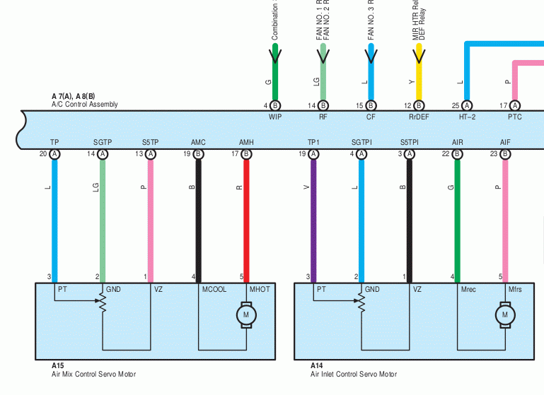

    I am wondering whether the root cause of the problem is the motor binding up; or the AC amplifier control unit. I've also been noticing slight noises coming from the dash of my 2004 but have successfully ignored them, so far.

    Here is what the servo circuits look like, being just a simple potentiometer for feedback. If the feedback is incorrect, the motor could continue to run when it shouldn't.
