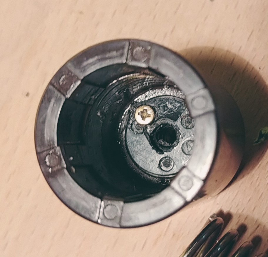

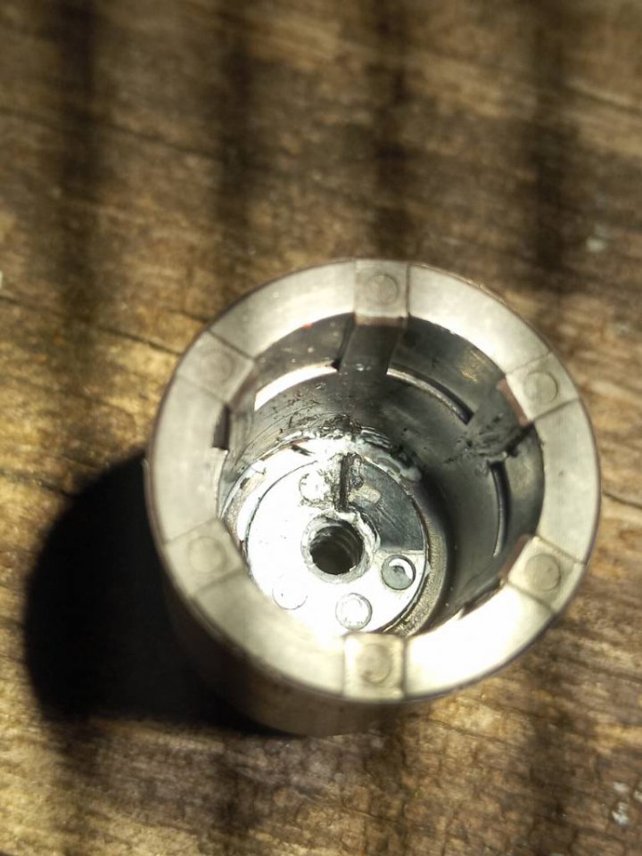

    Here picture of my ramp. Looks ok. And valve was completely seized and would not move even with force.
    I wonder why they have those ”venting” channels allowing dirt to enter electric motor compartment? And the screws were super tight to open..and Phillips..and i had to cut a slot and open with flat screw driver. Soaking with some penetration oil is good idea. And new screws.

    The very beginning of a rut, I see. The rotor is still being stopped, but a couple degrees past where it's s'posed to.
    Once that rut gets extended all the way through the highest part of the ramp, the rotor will go all the way past the stop, until it can't wind any further down the threads.

    What exactly is the purpose of the ski jump? Actual movement is done with the thread i suppose
