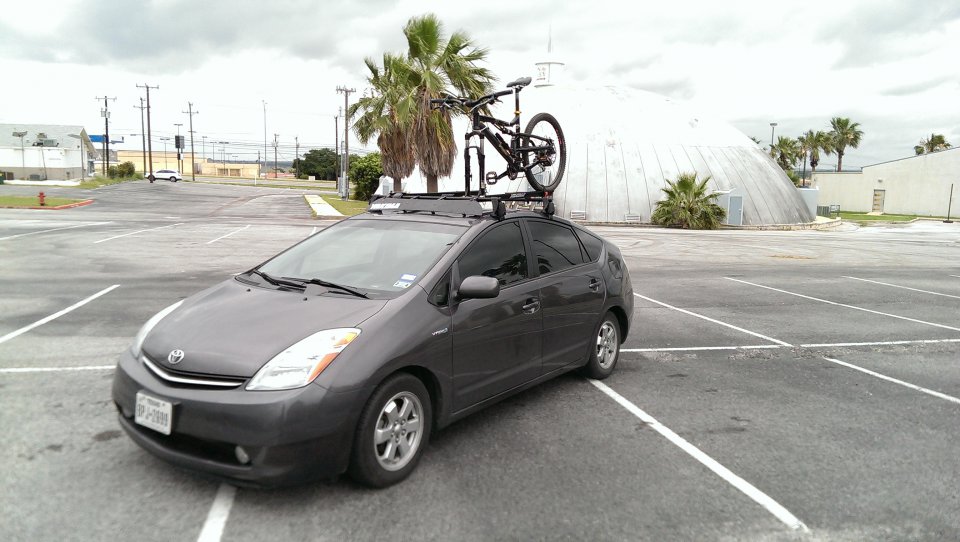

    this is my baby

    Personally, I'd put the bike inside the car. Toyota did a lot of work to get the aerodynamics to what it is. I'm picking that the rack & bike aren't improving this.

    dammit looks like ima have shitty mpg all the way to vegas.... and the bike rack didnt really affect my mpg probably just 1 if anything

    No, that rack & bike has a much larger impact on mpg. Even on my old FSP (fuel sucking pig) Subaru wagon, two bikes on a rack would eat up 2-3 mpg. Due to the nonlinear nature of the MPG scale, that translates to 8-12 mpg on a Prius.
    I have a hitch mounted rack for my Prius, and even it causes substantial mpg loss. For long trips, it is used only when there isn't enough cargo room inside for the bikes.

    If you don't drive very far with the bike on top then it's pretty inconsequential to your overall fuel economy.
    However, if the roof racks are permanently on there, then that will adversely effect your fuel efficiency.

    The bike rack itself will greatly impact your MPGs. On Fuelly, I had a conversation with a fellow who had a bike rack on his Prius, he saw a big MPG gain without it on. However, since he was bringing his Mtn. bikes wherever he went, it was the price he paid for the convenience.
    Your MPG hit with the rack and the bikes will be big (not 2 -3 mpg big, more like 6 - 10 mpg big).

    hmm ima have to remove the rack and do some testing then definitely not taking it on the road trip

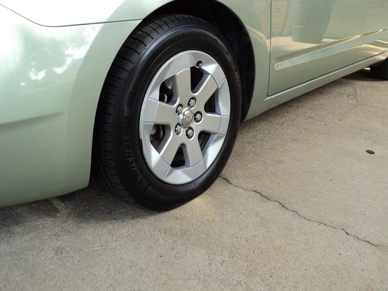

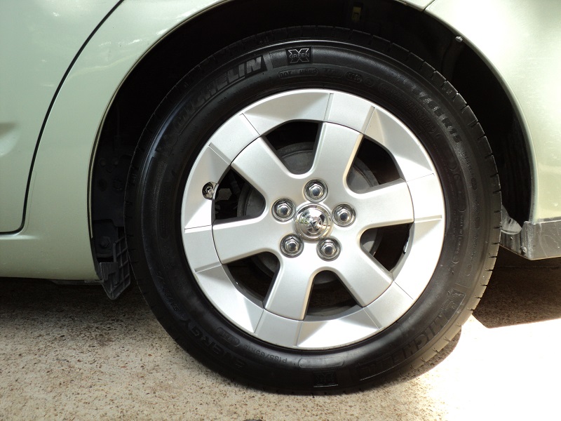

    I did not want to start a new string since this string revolves around "New Michelin Energy Savers A/S".
    Anyway, I did finally manage to locate a full set of them. I drove the car about a hundred miles or so after getting them mounted. I also had the alignment checked, the tech. tweaked the toe a little bit but said all was good.
    I did not note any major drop in MPG according the MFD. I just filled the tank and will be monitoring the numbers to see how the next few tanks run, but I really do not expect to see any drop in the MPG. I went from the crappy Goodyear Integrities to the Michelin Energy Savers A/S. As other's have written, I too note that the Prius tends to glide easier and further. Right now the pressures are set about two pounds over the placard setting. I plan on raising them up in a few days. I also declined the nitrogen since I am on a limited budget.
    Total price out the door $601.87
    I also wanted to thank F8L | PriusChat for his research and recommendation concerning these tires. If it were not for him, I would not have known about this excellent product!

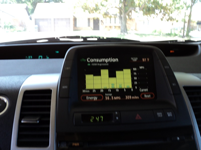

    Just a quick update. I am still on the first full tank of fuel since mounting the Energy Saver's earlier this week. The MFD is reading 56.5 MPG at 309 Miles. I am also running the air pressure at 38F, 36R which is giving me a very nice ride with excellent MPG.
    I never got those kind of number's with the old Integrities. Total miles so far on these new tires is 410, which means they are NOT broken in yet. I hope to continue to see the MPG go up from here.

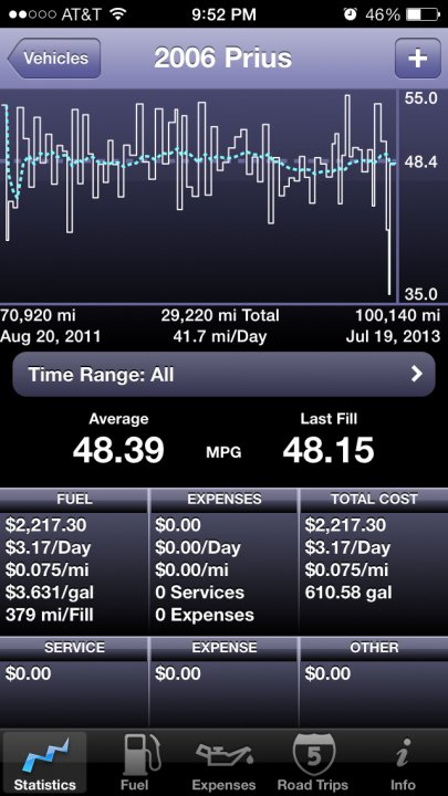

    I have these Michelin Energy savers going on my car tomorrow too and will be watching how the mpg is effected. They are replacing the Good Year Integrity tires which I hate! Horrible traction in wet and snow.
    I've been tracking my mpg since I first got my Prius 30,000 miles ago and the mpg avg for all those miles is currently at 48.39. I'm hoping the new Michelin tires help me get up to an average 50 mpg!
