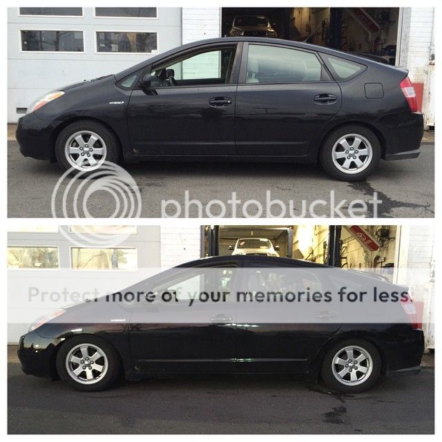

    I'm not new to online forums, but I am new here. I live in Arlington,VA and own a Black 2007 Prius, I've just recently as of this week done some suspension work. Tell me what you think, FLAME ON!

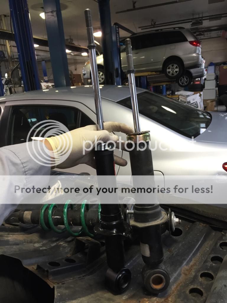

    I was able to grab some Tien lowering springs from a Toyota Matrix for $40 from a friend, then ordered some stock kyb shocks online and ran into a problem. Since I was using matrix springs the prius shocks were too long and pretty tiny honestly, so I ended up using shocks from a Corolla XRS that my buddy had laying around.
    Here's the final product(sorry for instagram photo, I never took one with my potato)

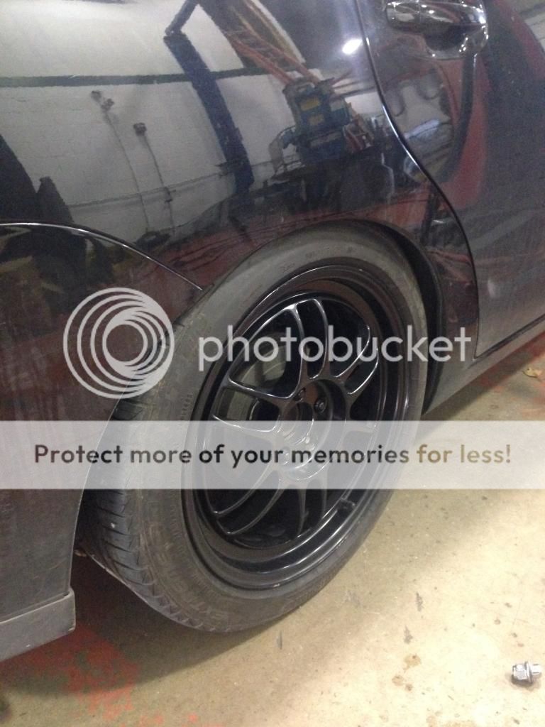

    Surfed craigslist and found a set of 17x8 +45 Enkei RPF1's with tires for $800, the tires were 225/45/17 and damn they fit nice in the rear. The front with +45 offset not so much..... so I'll be ordering new tires in the next few days.
    Still trying to figure out what tire size I want to run, I'm thinking 205/50/17 with a spacer in the rear. I want to run 215's just for looks, but idk how the front fender will enjoy that.

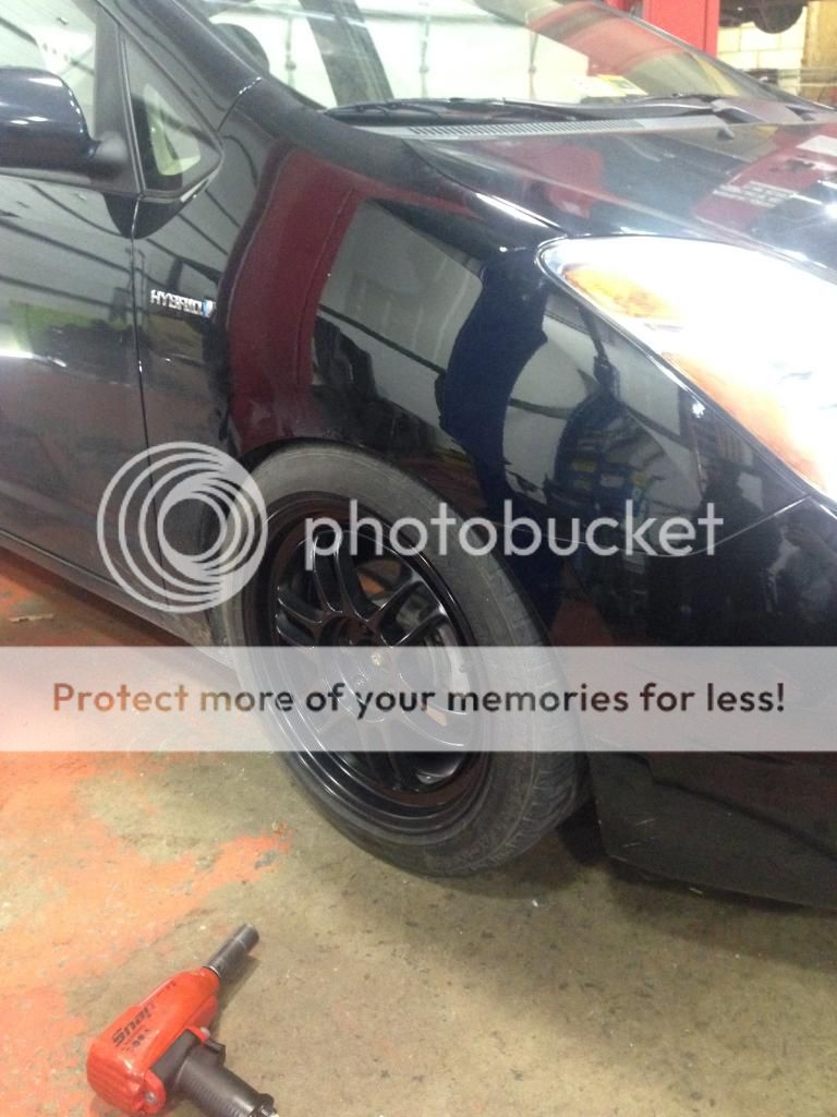

    215's and XRS sway bars getting installed Tuesday

    TPMS and 215/45/17 mounted

    how's it ride? no rubbing on sharp turns?

    10x better than before, only rubs on the front driver-side fender and then big bumps on the plastics. I'll be removing the fender plastic and rolling the fenders flush this week, I'm trying to decide on 10 or 15mm FIC bolt on spacers for the rear.
