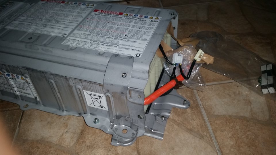

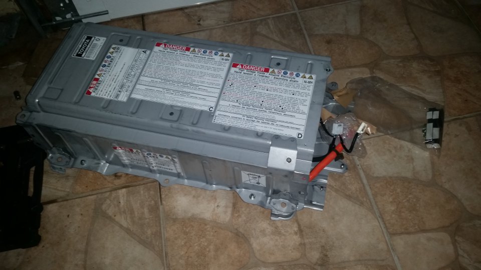

    I just got my new battery but it looks like it doesn't include the ecu. Is there a guide I can follow to take it off the old battery and put it on the new battery? 20140917_204917.jpg 20140917_204926.jpg

    You are correct, you need to move the system main relays and traction battery ECU to the new battery case. You can download factory repair manual info at techinfo.toyota.com which will be helpful. For example, you can download the exploded parts diagram to obtain tightening torques, obtain safety procedures etc.

    The pictures really do look like a new battery.

    It's a new battery alright. It has all those extra warning stickers on the case. Oem packs don't have all those stickers
