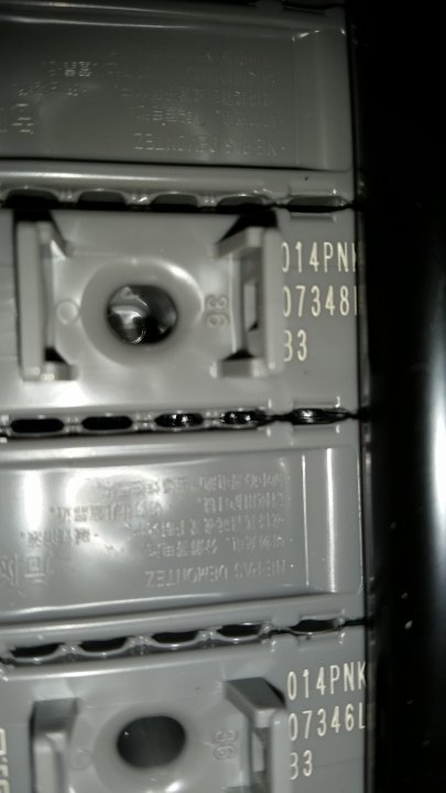

    Serial number is 014PNK07346L B3

    This must be a 3rd generation module as the decoding method Sagebrush shared doesn't apply to your serial number.
