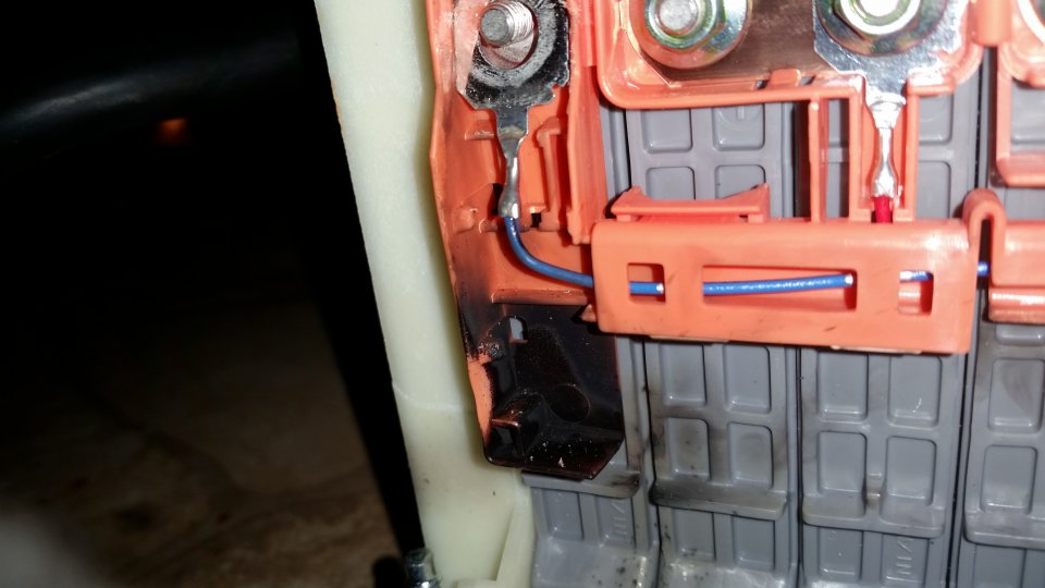

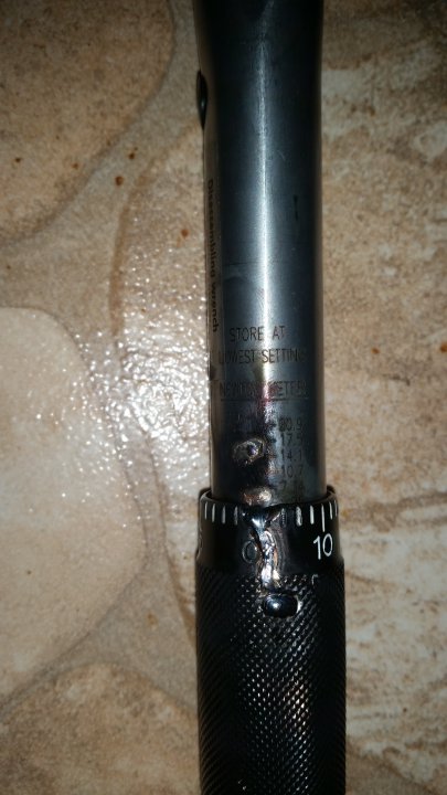

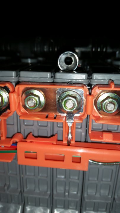

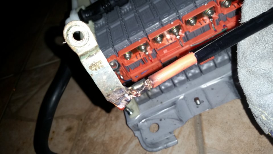

    The worst thing happened while I was working on the battery. I removed the two nuts from the two main battery cables. I tested 2 sense wires from what I thought was the sixth battery module and they all came back fine with perfect continuity. So I decided to loosen and torque all of the nuts that are connected to the sense wire to 48 inlb. I was tightening a nut when suddenly a HUGE SPARK came from the battery. It really spooked me out. The long main battery cable looks completely fried and the nut I was tightening has a slight burn mark on it. My torque wrench even looks burnt. I thought once the service plug was out the battery was safe to work on. I tested the module that I was tightening when the big spark occured for voltage and it came back a normal voltage similar to the other modules. What do you think happened? Is my new HV battery still even good? How can safely continue work on it? What should I do I spent $3300 on this battery I really need this to work

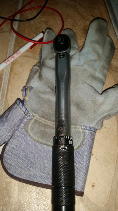

    This shouldn't be happening with a brand new battery. Something is not right here. Are the serial numbers on the battery all in sequential order??
    You have to be very careful working on this thing with the case open. You should be wearing the proper protective electrical gloves too. Your pictured gloves looks to be made of regular fabric??

    You thought wrong.
    When the service plug is removed then the series circuit is broken. However substantial voltage still exists, more than 100V on one leg (since the 2G service plug does not split the modules into two even groups.). As long as the busbars connect the modules, you can get zapped.
    My guess is that the busbars came from the original battery. Maybe one of the sense wires was damaged and caused a short circuit.
    You need to think about how the spark occurred. Was the wrench in contact with the sheet metal enclosure? If not, was it in contact with a sense wire from one module while you were wrenching on another module?
    Any damaged wiring must be replaced. You cannot safely operate the car with damaged insulation on the high voltage cables.

    The busbars did not come from the original battery the new battery had them already attached. I did however transferred the 2 main battery cables from the old battery to the new battery. I don't recall the wrench hitting any metal, but its hard to argue with the evidence. The burn mark on the wrench handle may have been where the wrench touched some metal on the battery. What I do know for certain is the huge spark came from the very end of the battery probably where the main battery cable connects to the negative terminal. The main battery cable is severely burnt so I know for certain I need a new one. And I need prober gloves. What kind of gloves do you recommend?

    Not wearing proper gloves is ridiculous.
    Rubber soled shoes seems like a no-brainer, as does working on a wood bench.

    No one should be apologizing for stating concerns over safety and like anything many people may be totally unaware of how close they come to a truly dangerous or potentially lethal situation. That being said people need to remember this person lives in Nassau Bahamas (not many choices for Toyota dealers and who knows how competent they are on a hybrid car either). So I would suggest that the batteries are likely fine (they can handle huge current in/out flows) but clearly the wiring (and your torque wrench) took the brunt of the issue and will need to be replaced or may have other issues (should be able to get used wiring from ebay). Ideally you should be looking at getting an RC charger then load test and capacity test the modules all again just to be sure everything is fine (may be a bit much to ask given your location and shipping costs). Anytime you start connecting all the batteries back together in series again you need to be very careful what you touch and I do suggest you familiarize yourself with a multimeter too (esp DC voltage readings, anything over 50V should have rubber insulated gloves as a precaution)

    Pictures look like the torque wrench body contacted the bar connector point.

    Agreed, seems pretty clear the torque wrench hit the connector and the dead short had him welding (ie big spark) in no time flat.

    Are wrenches made with rubberized handles ?
    Here are examples of insulated torque wrenches.

    Use an extension on the torque wrench, so the handle's well away from battery?
