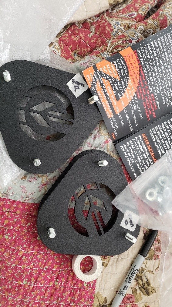

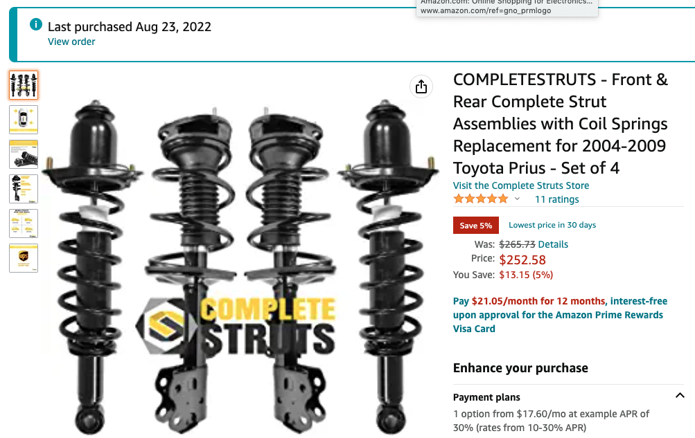

    Today, I received my lift kit from Priusoffroad and also received my non-oem strut/spring assembly from Amazon.
    Taking the car to a mechanic friend next weekend.
    I will update all once its done.
    Simba
    Lift kit
    I have no idea if these below will work or not but the car already has 300K miles.

    1. It got done - - sorry no pictures.
    2. A rod of some sort broke ("rust") while he was working on it and a 'new' replacement cost $50. He charged me $250 labor so total cost $300. I was happy to pay it. A few years ago he had replaced my AC Compressor and had only charged me $100 labor.
    3. I took my Family for a 200 Mile ride after I got the car back - -lift kit and new struts/springs. Amazing ride feel and no regrets.
