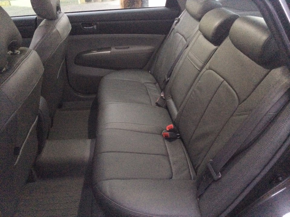

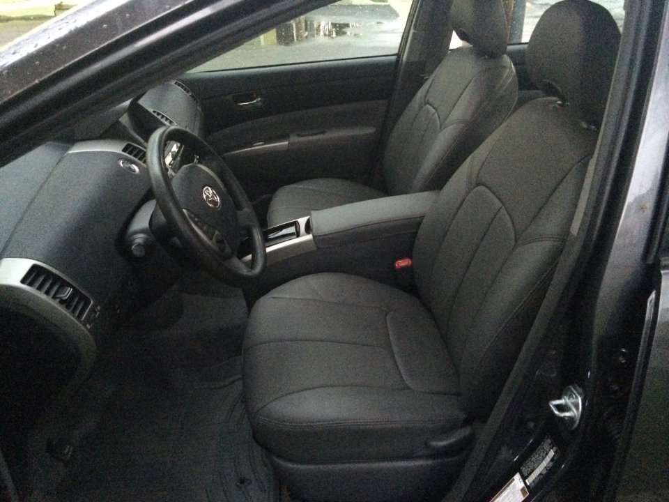

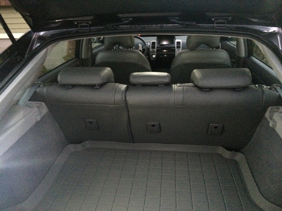

    Just what the title says... Took about 3 hours
    If anyone needs instructions or help doing this let me know. This is my second interior install

    Looks great! I've got a lot of questions!
    I have a 2002 Camry SE with leather, and the interior looks great - even after 12 years and 2 kids, the interior doesn't have any tears, no signs of wear at all.
    I just bought a 2014 PiP with the cloth upholstery because I didn't want to spend $5000 on the better stereo and fake leather. No matter what they say, I don't have faith that synthetic leather would last as long as the real thing.
    If an aftermarket leather kit wouldn't break the bank or or be too difficult, I'd seriously consider it. Did you do the work yourself? Was the leather a custom kit for the Prius or did you need to customize it?

    I installed this myself.. No modifications needed. The kit was made for the Prius. . This kit is from CLazzio. You have to understand that no leather interior is 100% leather. (OEM or otherwise) The seating surfaces, headrests and other parts are usually leather, while the rest is PVC or another synthetic. It needs to be this way so the upholstery can stretch over the foam. 100% leather would come out like a loose fitting bag.
    My first interior was a Toyota OEM interior. Built the same way. Installed with hog rings and pliers. This interior was 1200 from Toyota.
    This Clazzio interior cost me 390.00 shipped from trdsparks.com
    This went over the existing cloth, however I removed some of the upholstery from the drivers and passenger seat for a perfect fit.
    I've installed 20+ interiors in other vehicles. This is my second Prius interior.

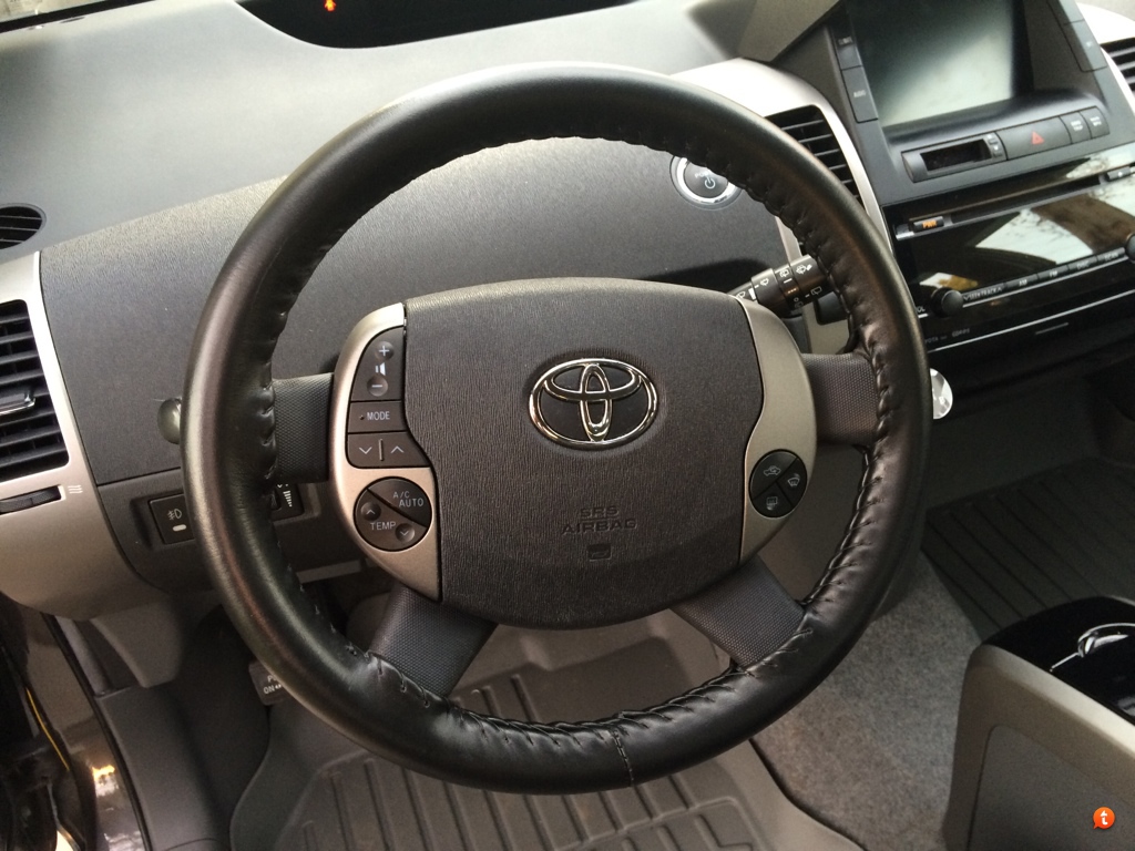

    Also installed a wheelskins cover today. Turned out good. No puckers or bunches. Trick is to condition and stretch the leather before you start[​IMG]

    beautiful! I'm looking at just doing the rear seats and center console, is it possible to buy that only?

    Yes, but parts cost is almost the same as the kit. Call them.

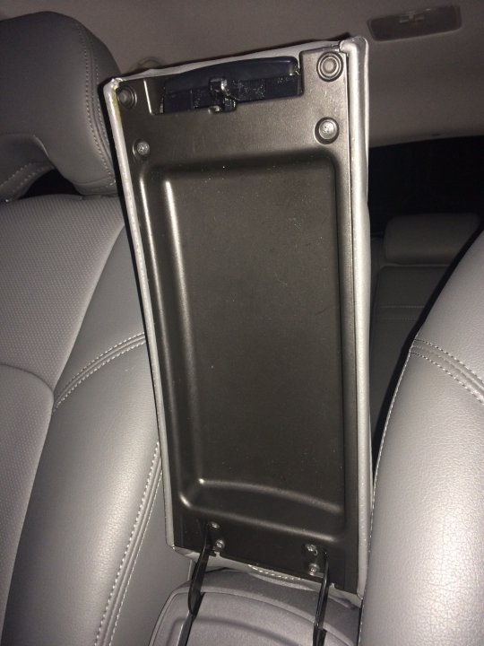

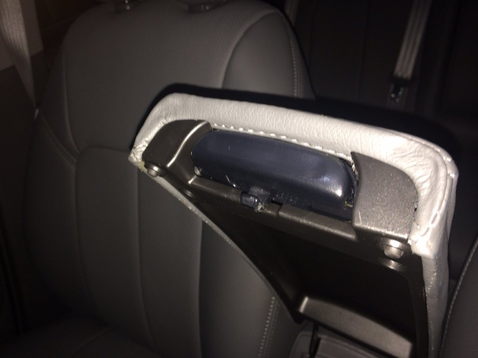

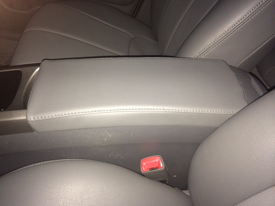

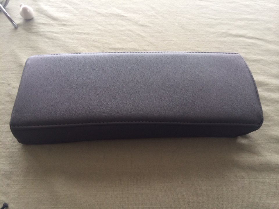

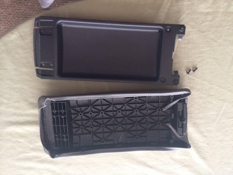

    If/when you get a kit, the poorest fitting component is the center console cover.
    This is how I do this - remove console, 4 screws. Unsnap bottom if inner lid and slide off
    Next, remove two screws and completely unsnap lid.
    Remove old fabric
    Now, take your new cover and carefully rip (remove thread) on the long seams so you can stretch the cover over the lid. Don't worry, it won't come apart.. It's double sewn on the ends.
    Remove and discard Velcro
    Get small alligator clips and thin cardboard ( think TV dinner box) to protect leather from marring. Use the clips to hold cover in place while gluing.
    Glue- use contact adhesive. Read packages and get a product that takes a minute or 2 to set, so you can stretch. Use stitch holes in cover as a guide, and stretch over lid. You'll get it when you start doing it. Only glue the leather inside the lid, not on top. It won't stretch properly if you do.
    Do this to both sizes, should take about an hour start to finish.
    When done put inner lid back on and screw everything back together. See pics of finished product below.
