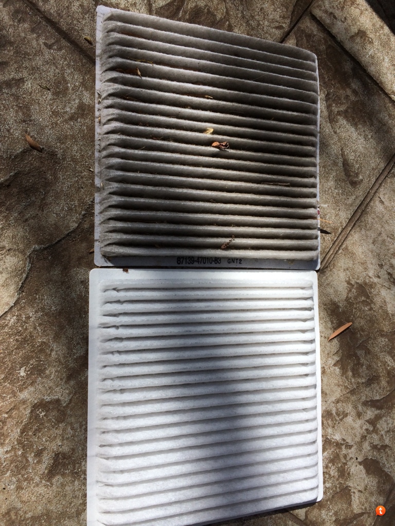

    Replaced the cabin filter, it's cheap and easy to do.

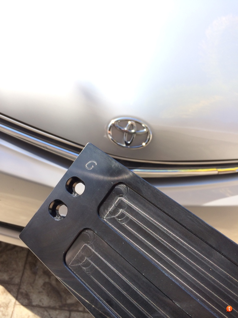

    Ordered the eBay special. G7 plate, not yet installed
    Will update once this is done.

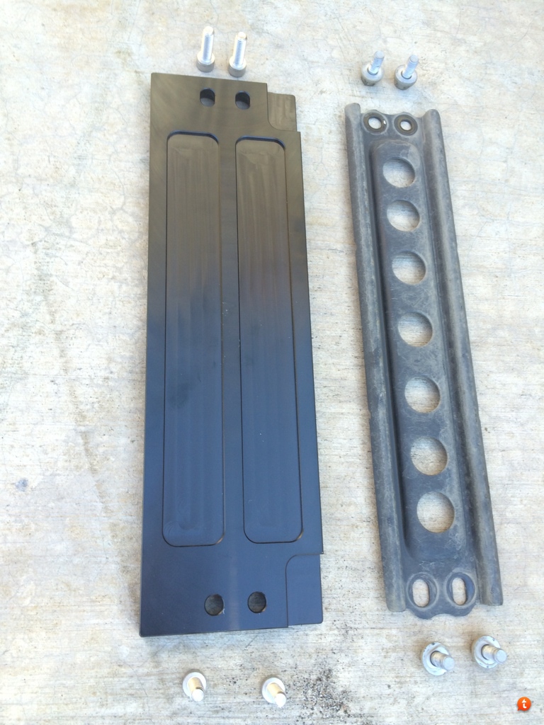

    This went in. Will update after I drive it. [​IMG]

    The stock one is flimsy and thin. The G7 was made nicely and stiff. I can notice a BIG difference on tight turns and on the freeway where the tires want to track the road with the STOCK brace the back end feels weird. With the G7 i can def. notice a stiffer feel. At $59 bucks this is a DEAL and would recommend this to ANYONE!
    Installation was easy. I lifted one side of the car and put a jack stand, Removed the stock 4 12mm bolts and re-installed the new brace and bolts with a allen hex socket and torqued to 34ftlbs. It took me longer to find the bolts and jack it up. This is something you can do with NORMAL hand tools.
