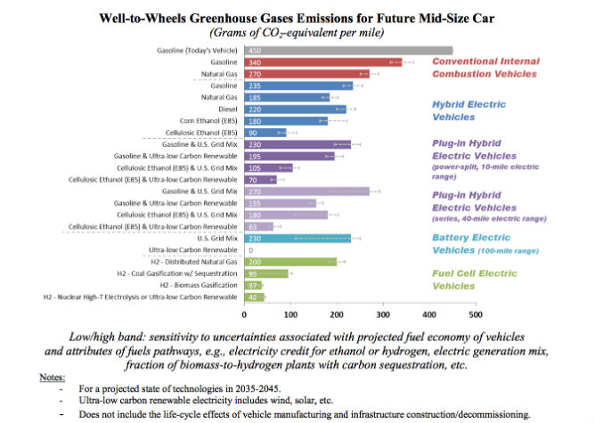

    It may come as a surprise to some but PHEV-40 (series) produces more emission than a regular hybrid. Morale of the story is that more EV miles in a plugin hybrid doesn't mean it is better.
    FCV (300 miles range?) is projected to be 15% cleaner than an EV with 100 miles range.

    Re: 2nd & 3rd bolded - From the nice graphic above in post #21, right below H2 Distributed Natural Gas is H2 Coal Gasification w/ Sequestration.
    Is that not H2 from coal and not natural gas?
    Why is better than H2 Distributed Natural Gas for CO2 emissions? Makes me think clean coal is behind the graph. I though you had to do a partial (messy) burn of the coal to gasify it.

    Wow, didn't realize H2 production from Coal is that clean! 95 g/mi vs 230 g/mi for EV with current grid mix.
    That's perfect. We have abundant of Coal and Natural Gas. Produce hydrogen from them and we'll have cleaner electric cars than BEVs. Plus, you refuel as fast as pumping gas.

    Agreed. I can't imagine the amount of energy needed for gasification of coal to hydrogen and the resultant byproducts. However, use of electrolysis is almost as complicated as building the fuel cells and or batteries. The fuels become contaminated using electrolysis and must be cleaned using specialized PEM filters. Contaminated fuel shortens the fuel cell life span. The space station has the advantage of already having pure constituents for its fuel cells. Its much cheaper and cleaner to do hydrolysis of methane into hydrogen.

    Now I get why this processes is rated so clean for CO2. The key word is sequestration. If your process involves actively and safely dealing with the CO2, then it does not count against your process ... *BUT* it does cost extra and it is identified as a challenge to overcome via research in the link you found. We can get all those CO2 figures down if we add "w/ sequestration" to the process.
