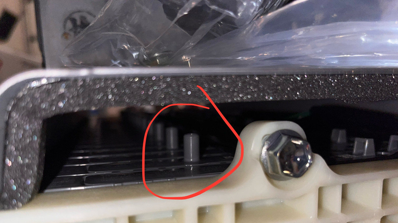

    Thanks. I will take the cover off tomorrow and look down into them. i'm pretty wiped today, as i drove a few hours to get this battery and back and had to unexpectedly take off the old battery control module when i got there when i realized the new battery didn't come with one. anyway, i'm attaching a picture of the new battery "vent" hole. like you mention they look different than the original which had a conical shape (titties that you eloquently called them?) at the top to grip the rubber vent harness

    Toyota phased out that vent tube system starting in I think 2011. The cooling system for OEM battery is a sufficient venting system, but you can use your old ones if want, they'll fit. There's a problem with the type of material those vent tubes are made with in that they interact with the gas that vents from the battery cells causing a foul smell. If you have a Prius with that smell coming out of air intake next to passenger side back seat not installing your old vent tubes will help prevent that issue.

    Yeah like I said I think all the new batteries that you buy now at the Toyota dealership or through that system The vents don't go anywhere You can put the rubber tubes on and the white y connector at the back and the tube from the car that goes to the floor all on they're just not doing anything I tend to leave them off it seems to give a little more room for air flow doesn't have to smash into those two big fat tubes that are almost an inch diameter taking up that space.

    Looks like there's a Gen 5 module now. The Gen 4 has a barb on that fitting. Can you provide a photo of the entire top of the module?

    The barb is there I think on most of the modules when they're not using the vent you can look down the little vent hole and see it goes nowhere You can put a tube on it and blow on it and it's just nothing full of vacuum on it little bury the gauge.

    You misunderstand what I wrote. Every Gen module prior to this "photo" has a barb at the top of that tube, whether the tube is used for a pressure relief or blanked off. That photo shows a tube that is straight and smooth from top to bottom, no barb. It's different, so must be Gen 5, which I've never seen yet.
