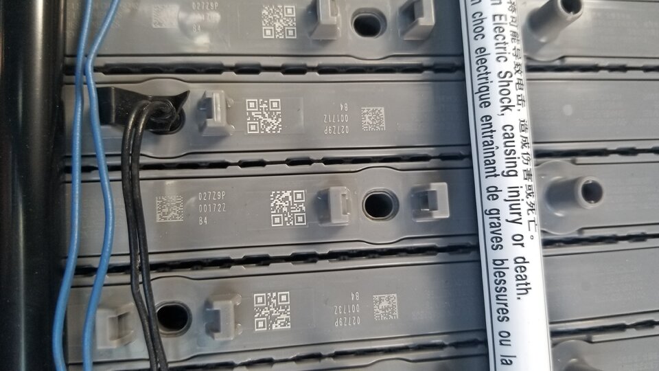

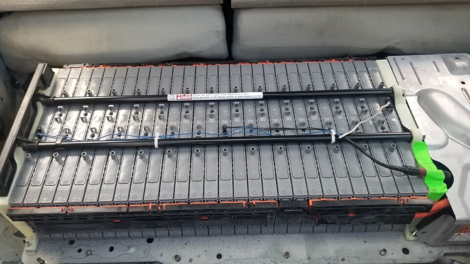

    Back with an update. Finally able to work on my car. See attached picture. So by the looks of it the modules all start with 027Z which means the battery was manufactured July 2, 2024. Looks to be legit?

    ????? How did you come up with that?
