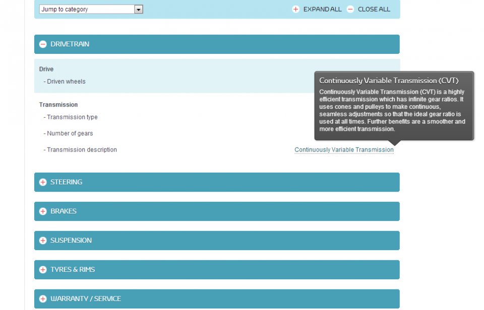

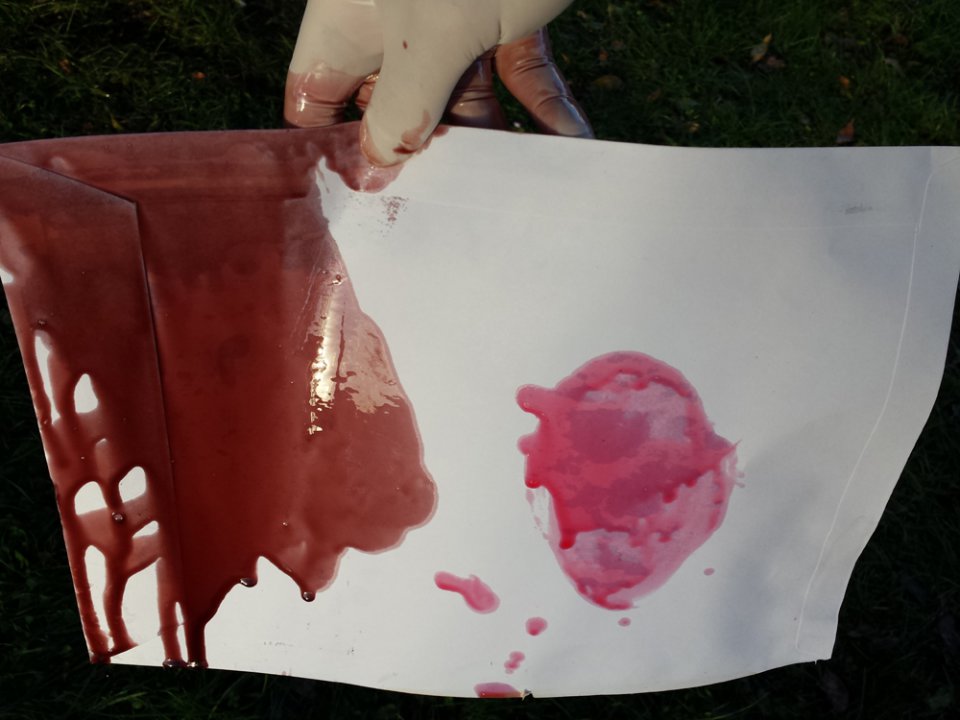

    I have been reading the forum a lot but decided to sign up and contribute. I recently got a 2006 and am very happy with it. I changed the oil and filter to 5w40 penrite. Also changed the cvt fluid, the dealer told me not too as they are sealed for life, I changed it and I am seeing quite a dramatic fuel economy improvement. You can see the difference in colour. I also attached a screen grab from the toyota site telling everyone the prius cvt has cones and pulleys!! The cvt is a work or art as it is all helical gears and is a differential, I would not have got one if it had cones and pulleys.

    The CVT is no more factory sealed than the engine oil is, from this site you can see pictures of a drain and fill plug. They recommend new crush washers but I dont see any leaking. I noticed nearly a 1L per 100 increase when changing the cvt and engine oil. The cvt fluid was stuffed so I think it has something to do with it.

    Please forgive my ignorance, but what does "1L per 100 increase" translate to in miles per gallon? Also, when you write "The cvt fluid was stuffed" do you mean it was some what perished or worn out?

    So 1L improvement is roughly a 10MPG increase. In fact this has now gone down again so the initial couple of weeks improvement seems to be slipping away.
    CVT fluid stuffed does indeed mean old/used insert anything you want really! I stuffed my arm could mean you broke/fractured your arm

    If you want to improve your mpg replace the Inverter coolant. You will see no mpg improvement changing the cvt fluid unless its really "stuffed" and yours wasn't becasue the original fluid looked pretty good.
