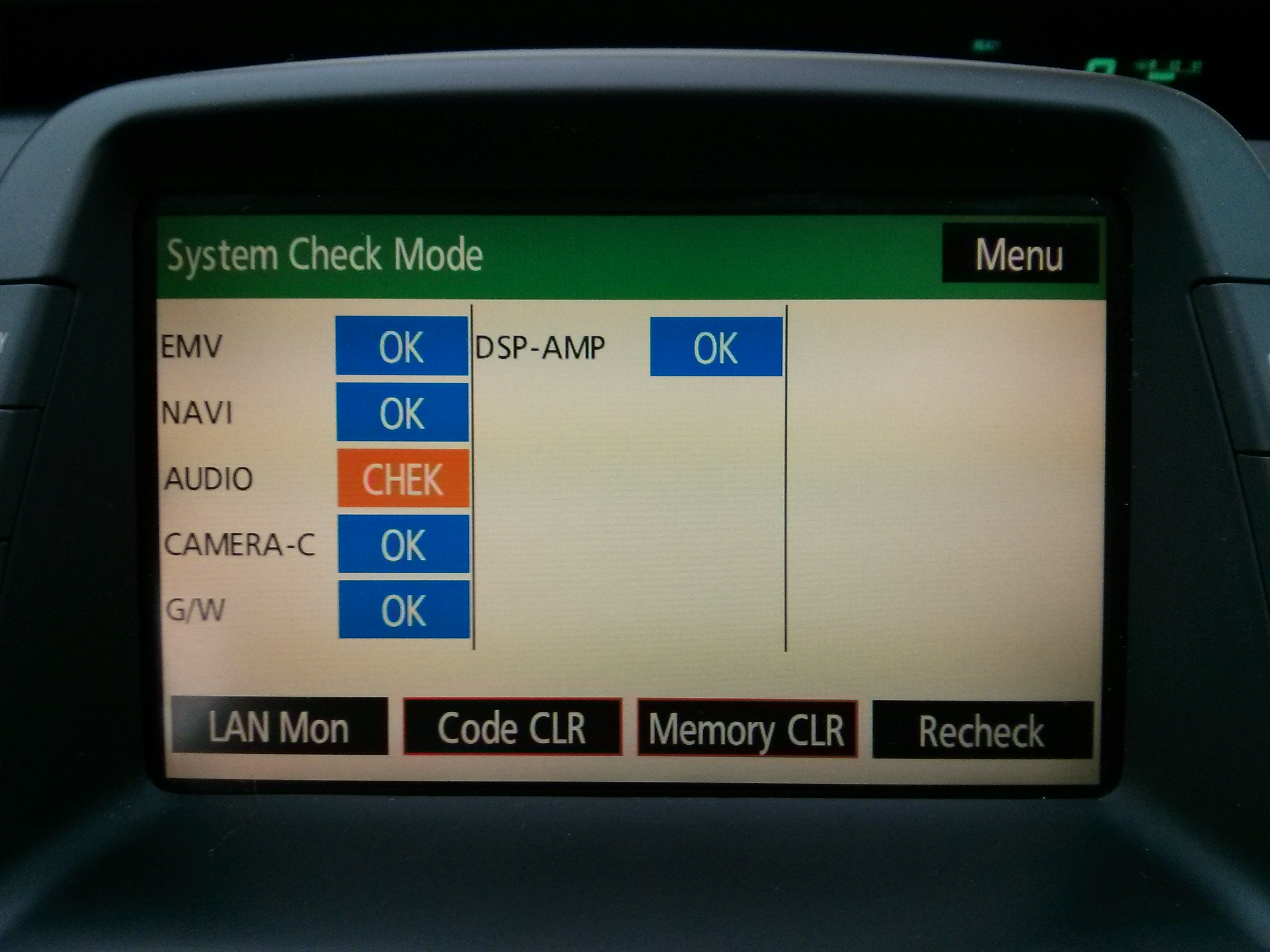

    Well, I have had the car nearly a week now and nearly 400 miles, and it seems excellent. Very quiet, smooth, comfortable, and just generally nice to drive. I have been getting about 62 Imperial MPG (which I guess is about 52 US MPG) which seems good to me. Have got a couple of issues, though.
    First up is the 12v battery. Thought I should quickly check it out as I guessed the car might still be on it's original, so just quickly did the MFD test. After a drive, and with no load, the battery shows 12.2v. After letting it stand for an hour, 11.8-11.9. I didn't want to try any more load on it, but I guess that's not brilliant. I haven't had chance to check it with a multimeter yet.
    Second problem I noticed while I was doing the battery test. On the self test, I get an error relating to audio. Again, I was just doing this quickly earlier to check the battery, so wasn't sure where to go any further than the picture I have attached. Is this likely to be a problem? I have the JBL system and it seems to work OK, but I haven't tested the CD changer yet.

    Get the 12v changed.
    Once they start, it's a slippery slope to failing.
    They're about £95 fully fitted. Be very very careful if you have to jump start your car and try to avoid doing so if you can. Do not let the other car rev their engine. And NEVER offer to jump start a neighbours car.
    If the 12v starts to fail it'll often give weird error messages and weird things will happen. For peace of mind just get a new one. Then you have a good car and the 12v will last another 5 years. (y)

    Most of the codes on the MFD do not mean much, the audio code could be the fact that you have no CD's mounted.
