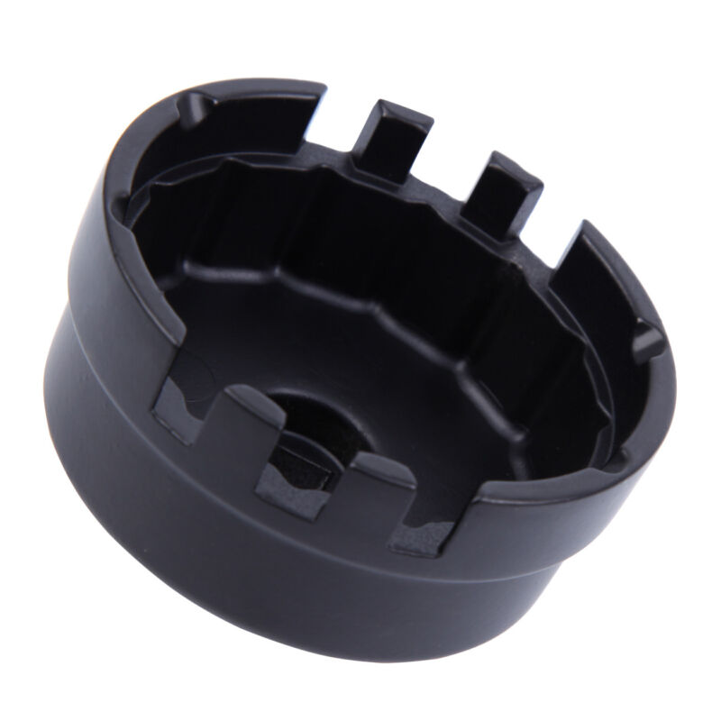

    This was the oil filter wrench I bought for <$5:
    This is what happened to it when I overtightened it with a 2' breaker bar onto a metal oil filter housing:
    Of course something gave, and I'm glad it was the adapter that broke. If I had made this mistake on my Prius with a plastic filter housing, I would surely have destroyed the housing and ended up in trouble.
    I suspect something shaped like this one might work out better (less likely to get stuck, as described previously):
  19. Mendel Leisk
    60,214
    41,413
    Aluminum? Try the heavy-gauge stamped-steel Honda filter socket; I've been using this one since '90.
    Works on Honda, Toyota and Mazda for me so far. They've all standardized the filter size.

    That bottom one looks like what I use.
