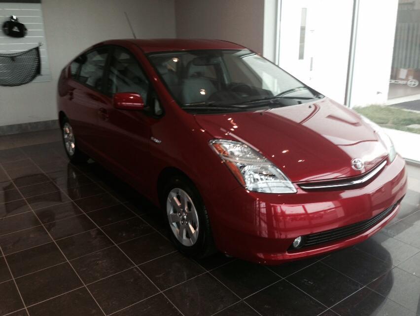

    Sorry to have such a long first post! But heres the picture i took when i picked the car up at the dealer!
    115,498
    52,878
    welcome to priuschat! congrats, she looks like a beauty. unfortunately, you're gonna get the 'it's a prius thang' at the dealer, so don't bother. there are some techniques you can try to get more gas in such as, removing the filler cap and waiting a minute or two for the pressures to equalize, pumping as slowly as possible, and try different pumps/stations to find one that works best and stick with it. all the best!(y)
