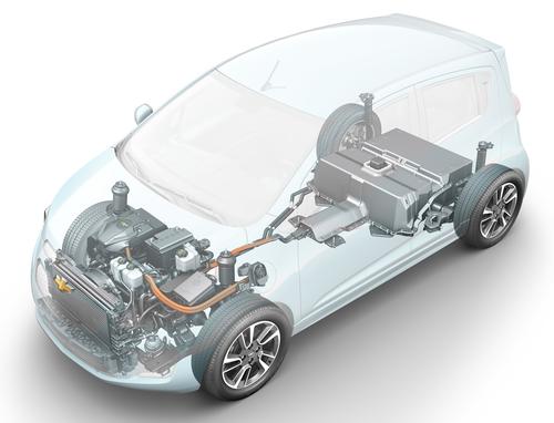

    GM's Spark EV could be the first to employ the new DC fast charging standard.
    (Source: GM)
    The standard calls for connectors and electrical interfaces with two extra pins on board. Electric vehicles and plug-in hybrids already on the road, such as the Chevy Volt, will not be able to use the new technology immediately, since they don't have the new hardware and software. However, Kevin Kelly, a spokesman for General Motors, told us its forthcoming Spark battery-electric vehicle will have the new connector, interface, and software. "It's less important to do this on the Chevy Volt, because the Volt already has extended range on board," he said. "But it makes a lot of sense for the Spark EV."
