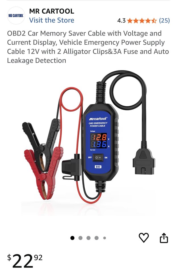

    If I was concerned about memory saving I might get this one or similar
    They claim reverse polarity protection, 7 amp capability (externally fused at 3 amps) and voltage/current monitoring. Which allows plenty of ecu headroom.
    It could have other applications such as parasitic draw testing.

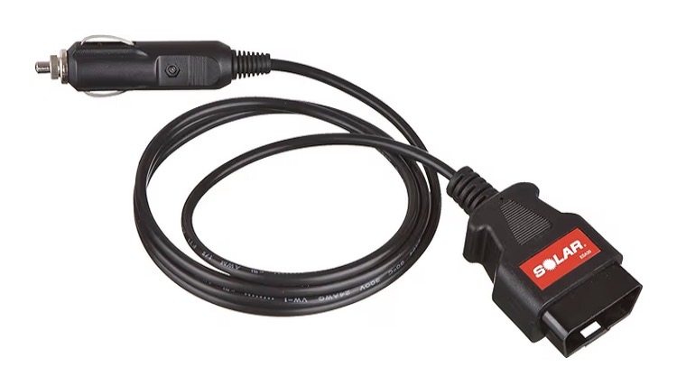

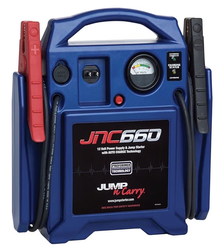

    I’ve used a Clore JNC660 jump pack:
    and a Clore Solar ESA30 memory saver cable.
    Lay the jump pack in driver’s footwell, connect cable from the pack to OBD port. Cable has only the power pins at OBD end, and has indicator light to confirm connection. I’ve seen some other cables, having indicator lights for both ends.
    memory saver cables are relatively cheap and ubiquitous; with appropriate extensions you can use them with most any 12 volt source, say a second vehicle’s battery.
    You can also just employ jumper cables with alligator clips, but they’re more awkward, could pop off, and lack indicator light(s).
