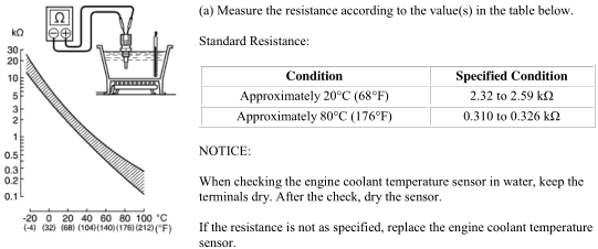

    The ECT is simply a temperature sensitive variable resistor. If you still got the old ECT; get some boiling water and hook it up to an ohm meter. Dip the ECT into the boiling water - there should be a resistance change. The water temperature reading should correlate to the engineering specifications of the ECT. If the ECT it good, it can only be a wiring or ECU issue.

    How does the ECT sensor work? It is in contact with the engine coolant and the resistance of the sensor changes when the coolant temperature changes. As the engine coolant increases in temperature, the resistance of the sensor decreases. See post below made by the very knowledgeable ChapmanF:
    Also ChapmanF wrote, "The ECM will log a P0117 if the ECT resistance gets so low it looks shorted. But that would correspond to a coolant temperature above 284 ℉ (140 ℃)."

    I would interpret it differently: if you follow a graph of the ECT sensor's resistance, you see that coolant would have to hit 284 ℉ (140 ℃) before a normally-functioning sensor would look like a short circuit.
    But what that's really telling you is that a normally-functioning ECT sensor really isn't ever going to look shorted, because 284 ℉ is well above the boiling point of the coolant at the pressure limit of the cap. If the coolant got close to that temperature, the clouds of sickly-sweet steam billowing out of the engine compartment would get your attention before a check-engine light would. (With any luck, you would already have noticed the red overheat light coming on at 248℉.)
    So in my interpretation, I would lean more toward P0117 likely indicating that there really is a short circuit somewhere, such as some insulation scraped or chewed off the sensor wiring somewhere. Such a problem, of course, would likely still be there after putting in a new ECT sensor.
