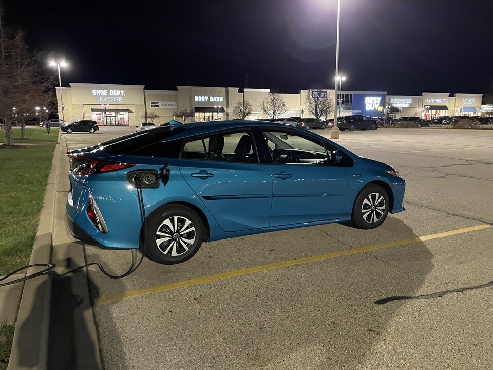

    Since I’m new to Toyota’s design philosophy - Previous PHEV was a 2012 Volt Premium - does the Prime charge the 12V battery from the HV battery when parked and ignition on?
    Reason being, my old Volt was great for live sound, power for your booth at an art fair, or DJing for up to 5-6 hours with an inverter. Just hook it up to the 12V, leave the car in “Ready” with all accessories (radio, fan, and headlights) off, and it would power a decent sized booth or DJ set for hours.
    Would doing the same on the Prius Prime leave me with a dead 12V battery? Or do I have to have the wheels moving for the HV battery to charge the 12V battery?
    Below is a pic of my Prius charging, what a great car!

    yes, as long as the car is 'ready', it's charging the 12 volt from the hybrid battery through the inverter.
    when the hybrid battery gets too low, the engine will come on and off to keep it at a minimal state of charge.

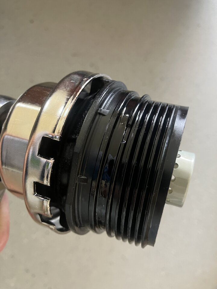

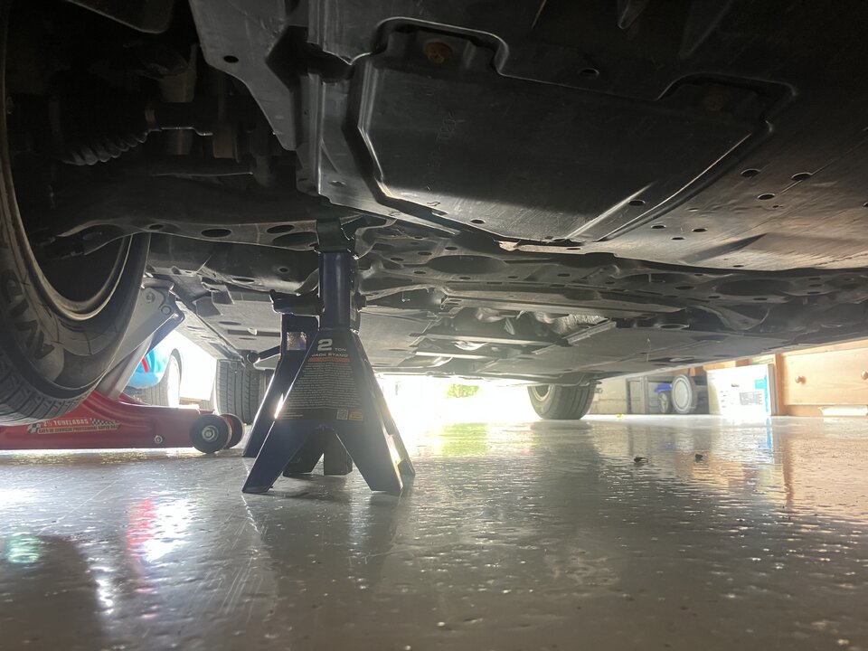

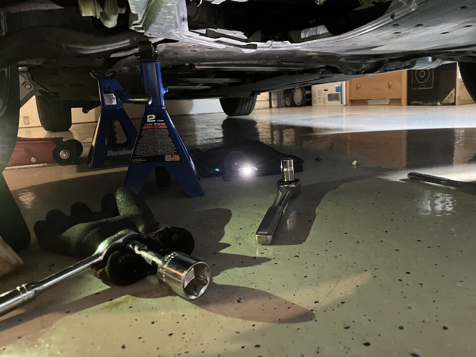

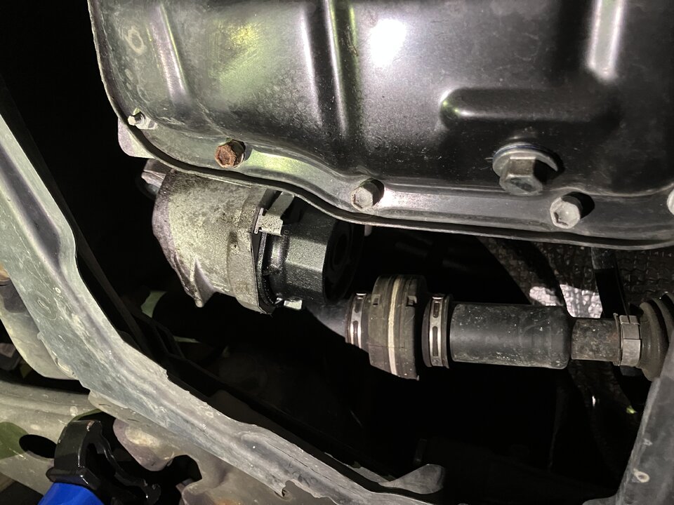

    Thanks for the recommendation. I just changed the oil today at 110,000 miles and it was pretty dark. Filter looked good though. I also changed this gasket on the oil filter housing. Do I need to do it every time or can I get away with doing it every other oil change?

    Those o-rings are good for longer than one oil change interval but inspect it to be sure...
    And for the love of god please only hand tighten those oil filter caps!
    I'm so sick and tired of those terribly designed oil filter cartridge systems showing up near welded on because some dipstick at an oil change place thinks its easier to use an impact driver to put 'em back on rather than hand tightening! Makes me so mad!
