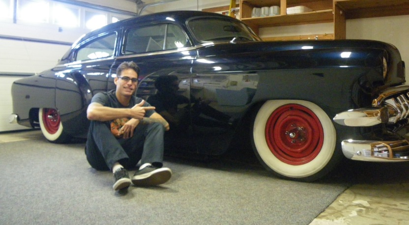

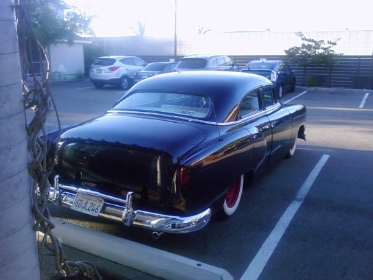

    Here's my non prius ride:

    nice ride you got there. prius makes all kinds of odd noises that you wouldn't notice in a normal car cause the ICE is always running. just take care of it like a normal car, you'll be fine.
