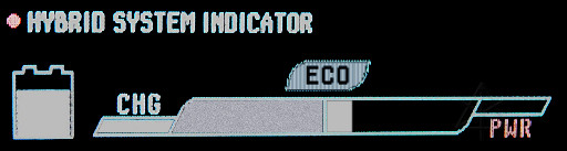

    I
    When I'm cruising, I tried to keep my HSI looking like this. When I'm accelerating, the bar moves a little more to the right but I try to keep it out of the "power" region.
    Jaybird124 likes this.

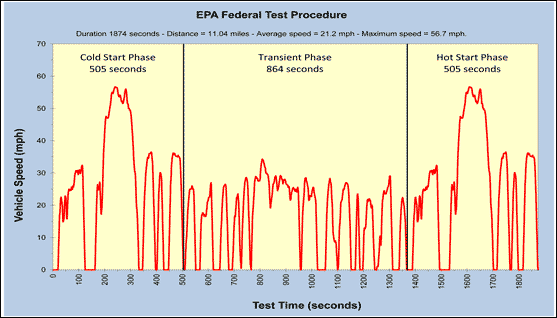

    Ignoring the thread does not turn off alerts to a reply to my earlier posting. Still, you've helped decipher the Consumer Reports puzzle. The August 2013 issue of Consumer Reports:
    source: pp. 50.
    More than a few of us have wondered how Consumer Reports gets such low urban mileage. They can not even reach EPA numbers and complain bitterly that the EPA does not justify their track nonsense:
    In contrast, every independent mileage database shows significantly better Prius MPG:
    If you want to achieve EPA mileage, you need to start by reading the EPA test protocol . . . and replicate it.
    Detailed Test Information
    But following the EPA driving protocol requires self-discipline and introspection:
    • accurate record of your driving profile - use a Garmin nuvi or GPS mouse to record your driving profile. This provides engineering metrics.
    • self-discipline to drive EPA style - bad-habits with former rides do not work.
    Your contribution is:
    This does not work with the Prius to achieve EPA mileage:
    1. Driving outside of the EPA test protocol returns different mileage.
    2. Driving the Prius like a legacy "gas and diesel engines" car achieves Consumer Reports mileage.
    Poor Prius MPG reports do not really matter:
    Mastering Prius driving takes a curious mind willing to experiment, to learn how the car actually works. Over 2/3ds of all Prius owners achieve better than 44 MPG and some can do significantly better.
    One last observation from the original GreenHybrid.com days. It turns out that Prius MPG performance is not so much a function of driving style as: routes and climate. One can mitigate some of the effects by driving style but it isn't worth it.
    Given your driving style, a plug-in Prius, Ford, or Volt might be a better match. Electric drive does a good job of dealing with lead-in-foot driving.
