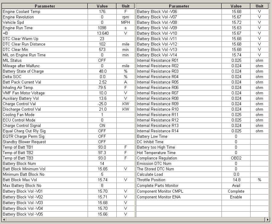

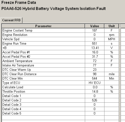

    Red triangle finally came back today, 4/15. I also performed a battery test as described in these forums on 4/11. I'll cover both here.
    P0AA6-526, Freeze Frame data in image below. If I'm reading it correctly, it took 98 miles since the last DTC clear (or at least clearing of this DTC) for this to reoccur. I also had the engine running a good while in park and some in drive with the brake on to do the battery test, so that would explain the 544 minutes to accomplish 98 miles of driving. It seems to add up. Nothing is sticking out at me as a red flag here.
    I should also note that, along with the P0AA6 DTC, I get the following code. I presume they are just secondary to the HV failure (the first one definitely only occurs in tandem with the HV leak code) or completely unrelated and independent (the Air Conditioner codes might be occuring on their own and before the HV code, I'm not sure yet).
    • C1310 - ABS/VSC/TRAC - HV System Malfunction
    • B1421 - Air Cond. - Solar Sensor Circuit (Passenger Side)
    • B1443 - Air Cond. - Air Outlet Damper Control Servomotor Circuit (w/ History)
    And here is the live data at the time of pulling the code, roughly 15 minutes after the DTC popped.

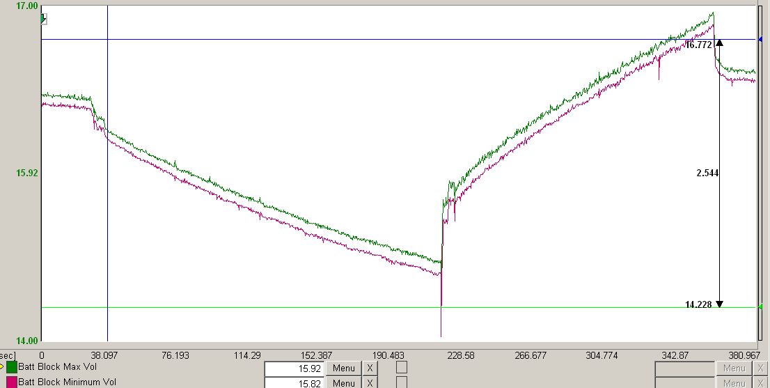

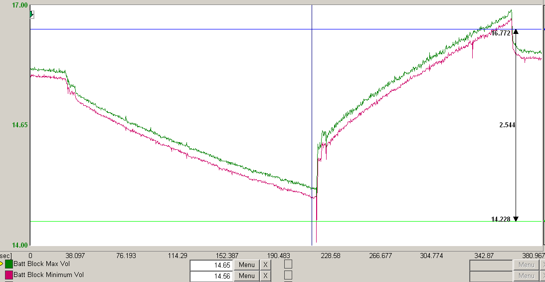

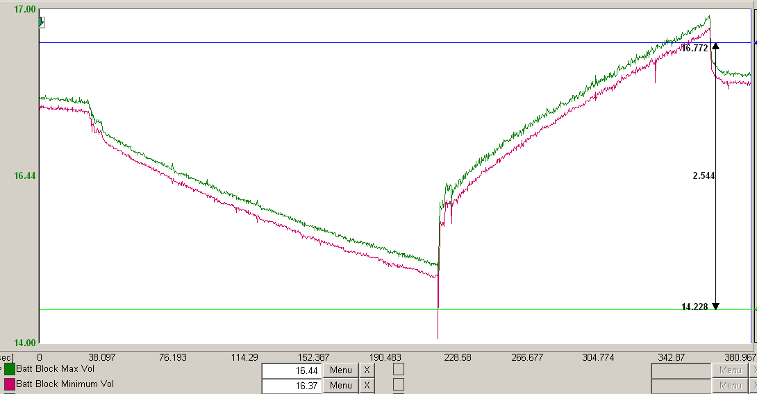

    Battery test...
    For those interested, I performed the HV battery test that I found on these forums. The test procedure is basically to put the car in reverse and cycle the battery with use of the accel pedal while monitoring the voltage differences of the battery cells. In one of the manuals, it specifies a threshold of 0.3 V or more between any adjacent cells as being a NG.
    During my tests (I performed this about 3 or 4 times, once during the p0aa6 DTC was active), the min to max voltage almost never went above 0.1 V and usually around 0.05 - 0.1 V range. Since the min/max voltage metric/data is the lowest measured cell and the highest measured cell in the entire bank at any given moment, and the were never more than 0.3 V apart, you can safely conclude that no adjacent cells could have been out of spec. So, at this point I'm calling the battery pack OK in terms of its ability to supply power and manage itself. However, I won't rule it out completely as the source of the HV leak (p0aa6). Until the problem is fully resolved, no component is ruled out as far as I'm concerned.
    Anyway, here are the HV battery test results from 4/11

    Your troubleshooting sounds like a good plan.
    Could you provide your techstream file? I'd like to take a look at it.
    Thanks,

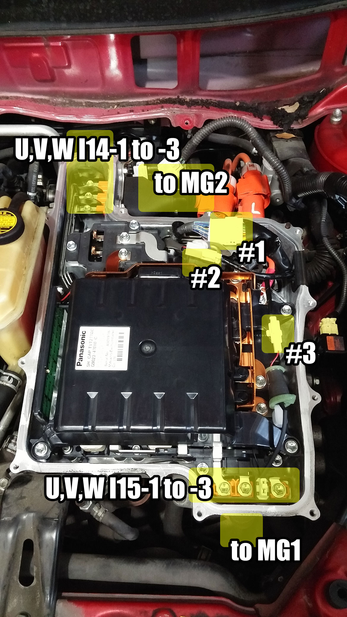

    After the last clearing, I've driving ~ 500-1,000 miles with no problem. Then, yesterday, I accelerated very rapidly and boom, red triangle within probably 30 seconds. So I finally got to pulling off the inverter cover and doing the final resistance tests. Here are the results.
    • Transaxle to Ground Resistance (HV-433 step #17)
      • U, V, W (I14-1 thru -3)
        • BAD
        • All three leads had ~0.5 Ohms (that's ohms, not megaohms :( ). This lead appears to be the one that goes to MG2, which would be the one I'd assume gets the most wear since it drives the wheels.
      • U, V, W (I15-1 thru -3)
        • Good i.e. >10 MOhm (Out of Limits of MegaOhm measurement on meter)
    • Inverter to Ground Resistance (HV-434 step #18)
      • U, V, W (I14-1 thru -3 and I15-1 thru 3)
        • At first the I14-x readings were bad, ~3.35 MOhm on all three. I had the supply and AC lines disconnected. I then disconnected what presumably are ECU comm lines that go back to the battery pack and the measurement turned good (see attached image, connectors labeled #1 and #2 specifically altered the reading). I wanted to ensure the inverter was completely isolated, but after further pondering these lines are disconnected in an earlier step from within the battery pack area before proceeding to these steps. If my assumption about the source of these lines are correct, then they should have technically been disconnected. I will have to search the manuals and see if I can find a concrete answer. For now I think the operating assumption is reasonable. And thus, the reader for the inverter is...
        • Good
    So now that it appears to most likely be MG2, I am assuming the transaxle will require replacement. I have some transaxle fluid and was planning on replacing it if the reading looked borderline, but it's almost a short. I'm surprised nothing caught on fire. I really don't even see how it could be THAT low and still have driven at all. It's basically shorted to ground.
    So now my primary question to the community is if anyone has advice on method for getting this fixed. I don't feel I am equipped to drop a transaxle and replace it. But, maybe I'm underestimating the requirement. I equate it to a transmission, but is it lighter and easier to get to? I definitely don't have a motor lift or anything like that. I have some jack stands and a very modest set of tools. Any thoughts/advice here?
