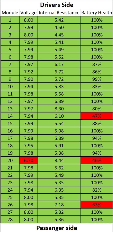

    My son and I recently bought a 2007 with a battery problem. Here are the numbers. What shuld we replace? (see attachement, red ones seem lith the obvious ones!)
    There are so many videos to measure all this stuff but non say "if it measures this, replace it!". We're not doing a mAh capacity test so please don't ask.
    Thanks in advance!

    How did you come up with the IR and percentage health numbers?

    I used the Viking battery tester from Harbor Freight for both IR and health. Used a voltmeter for voltage.

    Just replace module #20 with a replacement from: Oregon's Trusted Hybrid Battery Supplier: 2nd Life Story
    Replacing the other two would require further testing, charging and balancing to be sure and replacing them sooner than later might create more hassles rather than less because replacement modules need to closely match age and history of existing pack.
    It's ok to not do all the more than a dozen ways to test a module, first step is to get the pack going again and clean up the corrosion in bus bars, wires and ECU.
    In general, the first module you replace without much testing can last a year if you're lucky... Future module replacement will last less and less time and most people eventually get fed up and buy a new pack or professionally rebuilt one.

    One question, I see people talking about the IR being a main indiactor of health and having 15 or higher milli-ohms numbers. Mine all look pretty good, even the bad one. Why is that?

    The car measures in pairs, so the 14 IR values one sees in Techstream or Dr. Prius is the sum of two physical battery modules. 13/14 is 8.3 + 6.1 = 14.4, not 15 yet, but getting there. For comparison 1/2 is 5.42 + 4.50 = 9.92.
