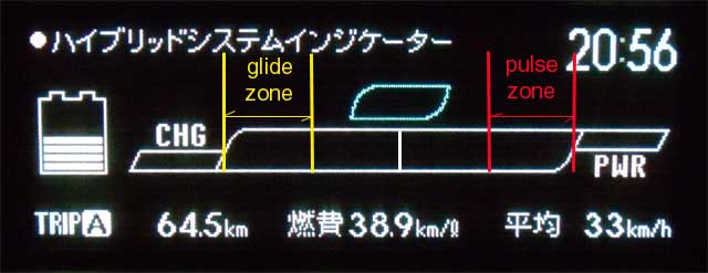

    Following is a copy of my post.
    In Japan, we have been discussing how to pulse&glide on the 3G Prius.
    Our conclusion is we don't have to be so sensitive for the zero amp gliding and a weak battery use is acceptable, therefore 0-25% zone on the HSI screen is acceptable.
    Also, a slow acceleration is not good for the ICE efficiency, therefore 75-100% zone is recommended for pulsing.
    Ken@Japan

    wow, thank you ken, i gotta try this out.

    Thanks, Ken. I would like to make clear that when I say 1/2 to 3/4 of the HSI bar, that is the lower segment of the same area you describe and is depicted in the picture I linked as well. I'm glad our friends in Japan agree on this method.

    "Weak battery use is acceptable".
    This is good to know, thanks.... but what do you recommend for people living in very hot climates for the glide when having to use AC?
    Personally I will never glide in the range you list above since it drains the battery. I have it so the bar is completely disappeared when using AC. If I use windows or no AC/windows rolled up I will use sometimes your method for the glide, but mostly bar disappeared.

    I too try to have nothing during the glide. But I think his point is that it is probably acceptable to be in that range for small segments of time to avoid another small pulse or other traffic concerns.
    I definitely agree with his pulse zone area. Personally I aim for the middle of that zone or even a little past middle.
