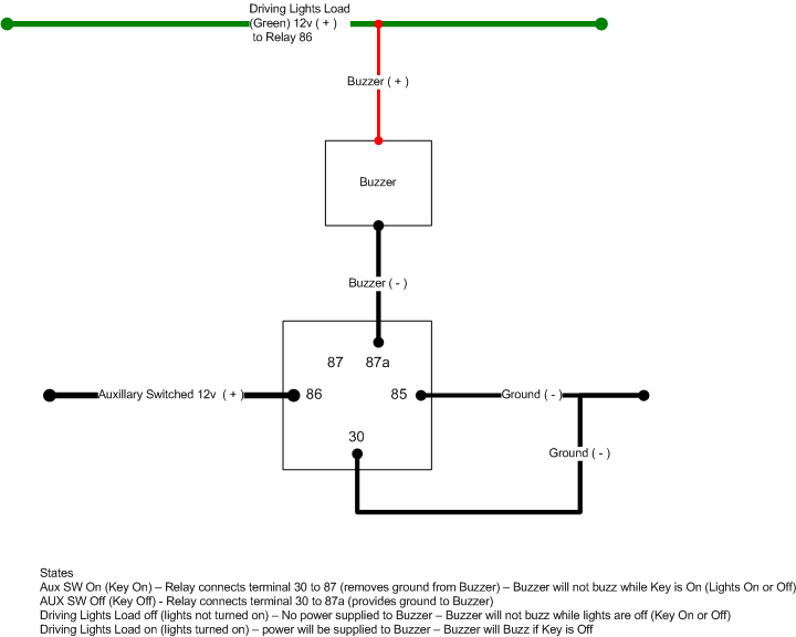

    A simple headlight warning buzzer can be installed yourself if the car doesn't have it (which I find hard to believe). A small piezo-buzzer can be wired between the ignition-circuit and the headlight circuit. Because it contains a diode, current can only flow in one direction, therefore the buzzer will only sound if current flows from the headlight circuit, through the buzzer, and back to ground through the ignition circuit, when the ignition is turned off. The rest of the time, the buzzer is silent because either the ignition-voltage balances the headlights-voltage, causing no current-flow. The other silent-state is when no power is being supplied to either the ignition-circuit or the headlights-circuit.

    The headlamps are not a problem as they go off as the ignition is turned off so do not need a warning. The European Prius although mechanically similar to the US Prius in other respects is very different. Large differences can be seen in the areas of, brakes, cooling system, fuel system, security, wheels, and electrical systems.
    The Prius is the first car I have had out of approximately 60 in my life that has any audible warning device, and must admit I find the Prius buzzer annoying to say the least. I did have a Chevrolet as a loan car last year that bonged at me every time I opened the door or sat on the seat without a seat belt. I felt it obtrusive and annoying, and not wishing to sound anti American, but telling the truth the car although brand new was a piece of junk as bad as some of the cars we produced in the UK in the 60's and 70's.

    I'd rather be annoyed by a buzzer than be annoyed by a dead battery, any day of the week.
