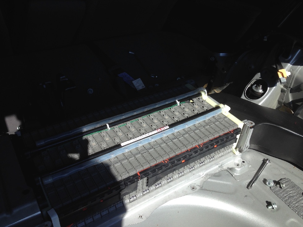

    image.jpg In Europa, its the same Problem with smell from HV Batterie-Tubes on Gen2 Prius.
    This is a work with Silicone-Tube:
    image.jpg With the original Ends.... and small drilled Hole for switching...the Modules...
    image.jpg The smell ( Horse or Cow Piss) is 100% from the original black Tubes , in this pic the upper Tube....

    I have replaced them and the smell is gone. A few days with the windows open during day time on the drive way and all was good after two years of Toyota refusing to take care of it unless I pay for parts and labor.
    Those tubes are not part of the Hybrid battery and therefore not covered by the hybrid warranty.
    I therefore conclude I also do not lose the Hybrid warranty swapping the pipes myself.
    A few more folks have now done so. Once you small again on the pipes after your car is free of the smell, you seriously ask yourself how you managed to use the car before at all.

    I have replaced them silicone tubing and it is much better. Occasionally I still get a funny smell but this might be to something else or there is a leak in my modification. I believe I will never completely get rid of the smell, however it is substantially better now. It wasn't very difficult job and I done it with a help of my partner. Obviously you must take a precaution as you're dealing with high voltage. Original tubes were very sticky and they smelled very bad.
