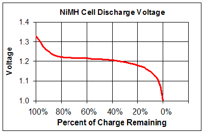

  16. ChapmanF
    27,652
    18,248
    For NiMH? Based on the graphs I'm managing to find in a quick search, that seems to make the word 'almost' do quite a lot of work.
    Fred_H likes this.

  18. ChapmanF
    27,652
    18,248
    Maybe it bothers whoever made the graph. That wasn't me.
    I picked one of the simpler graphs from a quick search like this:
    nimh discharge curve - Google Search
    There are plenty of others, many of which appear suggest that temperature has a lot to do with the voltage at 100%.
    I'm not seeing any, in a quick glance, that would make me agree "from 1.45 to 1.2 V we can say that this is an almost linear graph".
    Fred_H likes this.
  19. Xeico
    Xeico Member
    Jan 16, 2024
    46
    Folsom
    Here is an example, unfortunately this is not from the datasheet from Panasonic, but you should not compare ordinary batteries with batteries for the automotive industry. The Prius has high current cells and the graph will look like a red line.
    Yes, there is a drop from 1.48 to 1.38, but it is not as significant as below 1.2 V.
    Unfortunately I don't have a new or very good NIMH blade to test with, but I'm pretty sure that most of the charge is above 1.2V

  20. ChapmanF
    27,652
    18,248
    I'm neither on Jack's team nor a customer; the battery in my car is the NiMH one that Toyota put there.
    I merely made post #96 because I read "Roughly speaking, from 1.45 to 1.2 V we can say that this is an almost linear graph" in #95, and that didn't seem to fit what I remembered from looking at NiMH discharge curves, and so I searched a bunch of them up and it still doesn't seem to fit, and even the red trace in your latest attachment would be hard for me to describe as "almost linear" unless maybe in a narrower range like 1.28 to 1.25. In the range up to 1.45, to my eye at least, the curvature is quite noticeable.
