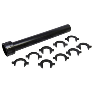

    I did also get a new inner tie rod assembly and the removal tool from my local auto parts store, went home and realized that the tool wouldn't fit over the part! The shaft of the tie rod is too large to fit in the pass through groove of the style of tool that they have. It would take about 30 seconds with my die grinder to widen the grove to fit, but before I purchase and modify the tool I think i'll try to see what the other brand of auto part store has to see if theirs would work. I don't have much choice to get it replaced where it sits as I did cut the bent part of the old rod off!

    Which end is left that you're trying to remove? The tapered joint into the knuckle? Is the tool the from the parts store one of those fork-shaped wedges?
    The only time I needed mine off, when I did my wheel bearing, I just stuck a small 2-jaw puller over the arm and tightened moderately against the end of the shaft, and I wandered off to get goggles and a hammer in case it needed more force. By the time I wandered back the tie rod was out and the puller was lying on the ground. :)
    -Chap

  14. ChapmanF
    28,721
    19,020
    Ah, right. I never had any reason to deal with the inner.
    It's funny, none of those tools look much like what Toyota shows in the manual, which is a lil stubby adjustable wrench (used with a regular open-end to hold the rack proper).
    The little adjustable wrench is stubby because its handle also has a square hole for a torque wrench. There's a specified torque for installing the new inner rod (page SR-23). Because of the length of the stubby wrench, they've taken the real torque and figured out what reading you'd actually see on a torque wrench with 380 mm fulcrum length. If your lengths are different you have to do the math over yourself. :)
    -Chap

    It's possible to get a standard crescent wrench up in there, but try as I might I wasn't able to crack it free. I was able to find a tool that barely slid over the top and got it off this weekend! Now I'm waiting on a new Tie Rod. It completely shredded the little tabbed washer but the guy at the parts counter of my local 3rd party store told me that it's supposed to come with one, and he couldn't find a part number on it.
