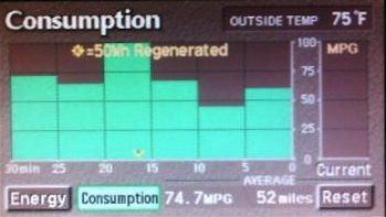

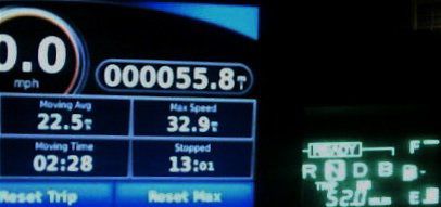

    I ran a preliminary test, not even fully inflating all tires, just to see how the P195/70r14 Yokohamas might work out:
    [​IMG] [​IMG]
    • 55.8 / 52.0 = 107.3% +/-0.2 %
    • 52 / 74.7 = 0.696 gallons
    • 55.8 miles (GPS)
    • 55.8 / 0.696 = 80.17 MPG (true)
    Correction, a 954 mile tank. We won't really know until the new rear tires are mounted, wheels aligned, and fully inflated tires.
