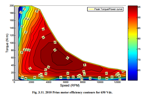

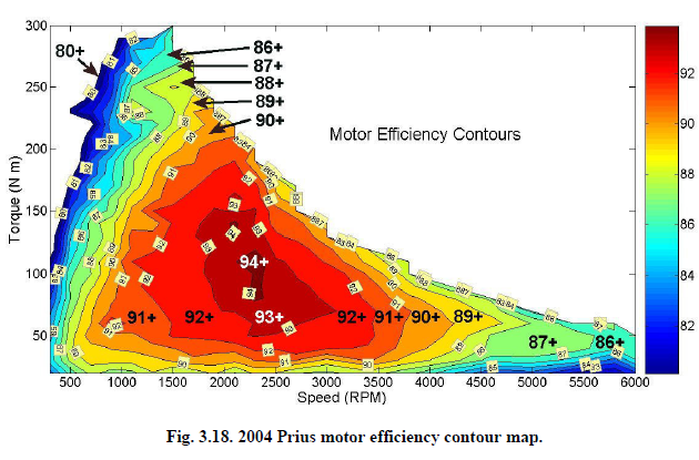

    I was thinking about a geared electric motor and realized that it may lead to higher efficiency in some partial power bands. So I started a Google search and sure enough, motors have efficiency curves and in some cases peak efficiency in a subset of the torque-rpm band. Thinking about it, there are parasitic core losses at higher speeds as well as mechanical and capacitive losses.
    The secret of Prius efficiency has been running the Atkinson engine in peak efficiency power range and use the hybrid transmission and battery to handle the inefficiency power needs. But the same rule can be applied to the electric motor and that may be what is behind: 2017 Hyundai Ioniq Electric Steals Energy Efficiency Title From Toyota Prius Prime | CleanTechnica

    2 Gen Prius MG
