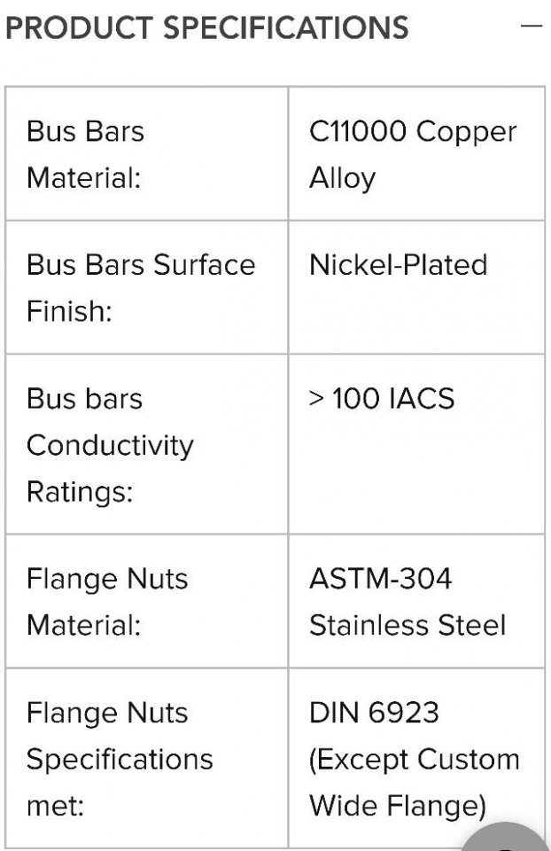

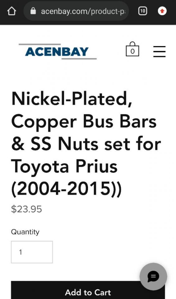

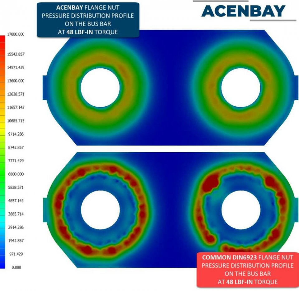

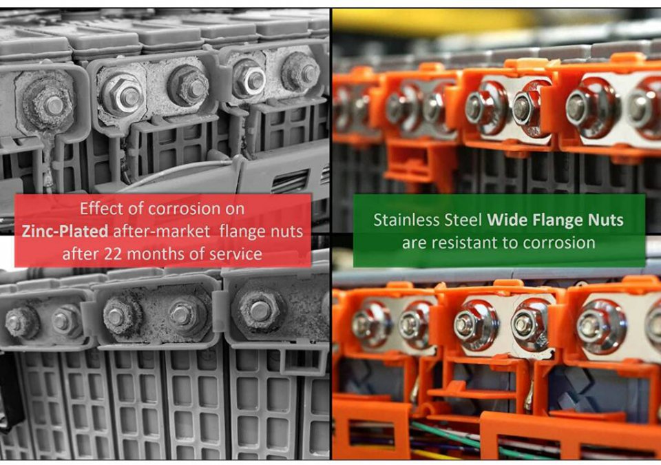

    I have found an excellent bus bar kit specially made for the Nexcel Lithium battery.
    This is from AcenBay.com for only $23.95
    With better nuts with wider coverage.
    They also have complete kits for non Nexcell batteries.
    I was able to score us all here a 10% discount with promo code "azusa"
    The fact that this company made a kit for the Nexcell battery shows their passion for our hybrids and they are also Nexcell battery owners like us that have them.

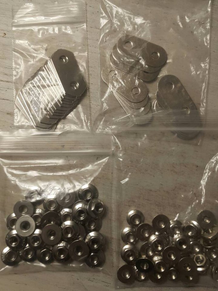

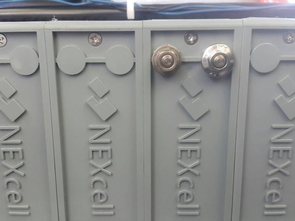

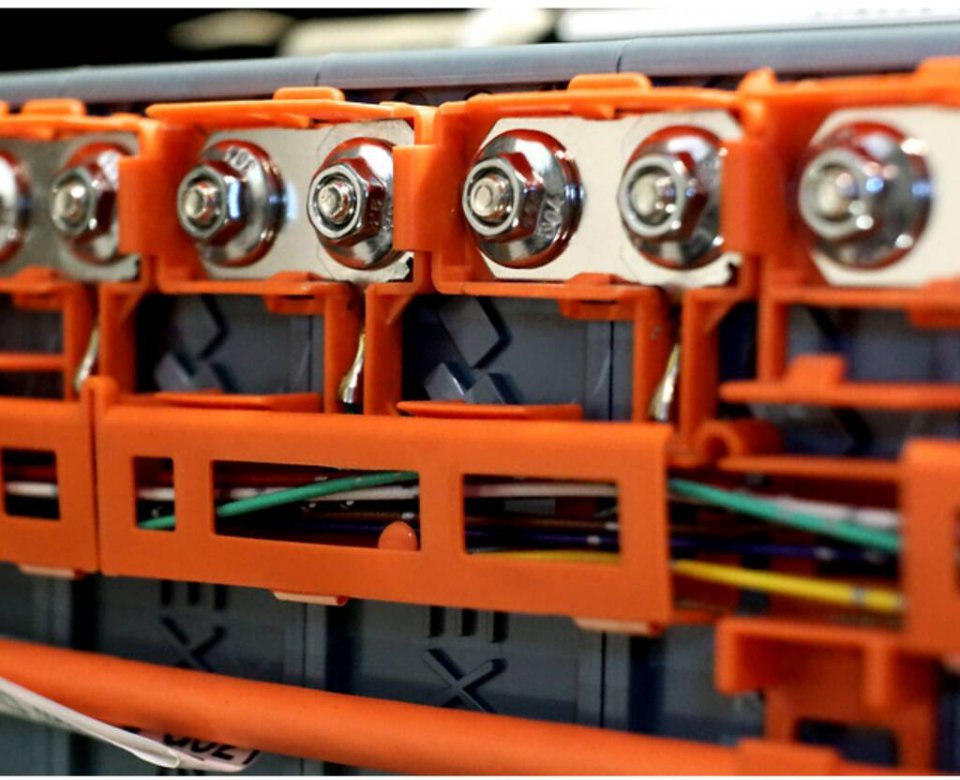

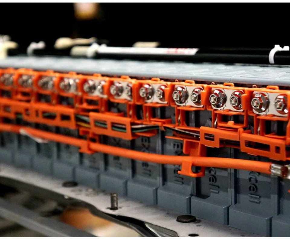

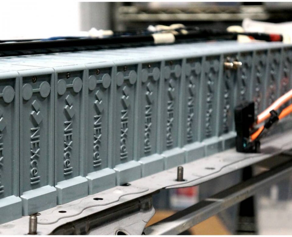

    I have attached pictures of two kits, one from AcenBay.com and one from Ebay.

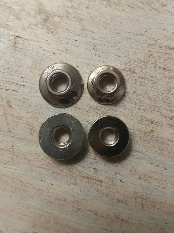

    You will see the difference between the kits bus bars and nuts, both being nickel plated
    The one from AcenBay has a wider nut.
    The ebay kit has a smaller nut which is more like OEM.

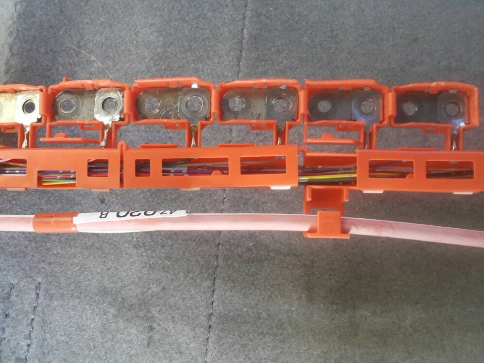

    I will be installing these this weekend to upgrade them from my old ones which are old nickel plated and in poor condition.

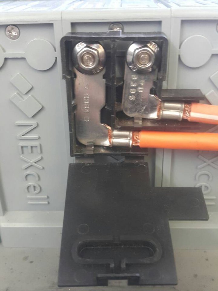

    For a link to the Nexcell site, check my profile page for the Project Lithium link.
    First and second picture has AcenBay to the left of the Ebay kit.
    The third is just of the AcenBay kit.

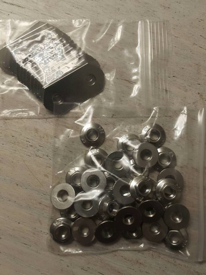

    Then detailed pictures of the AcenBay kit.

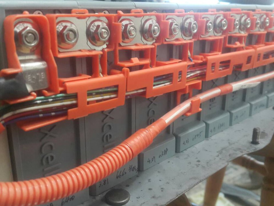

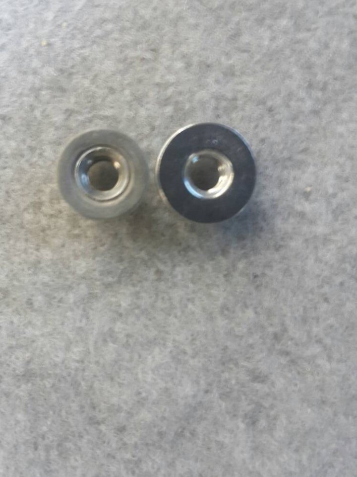

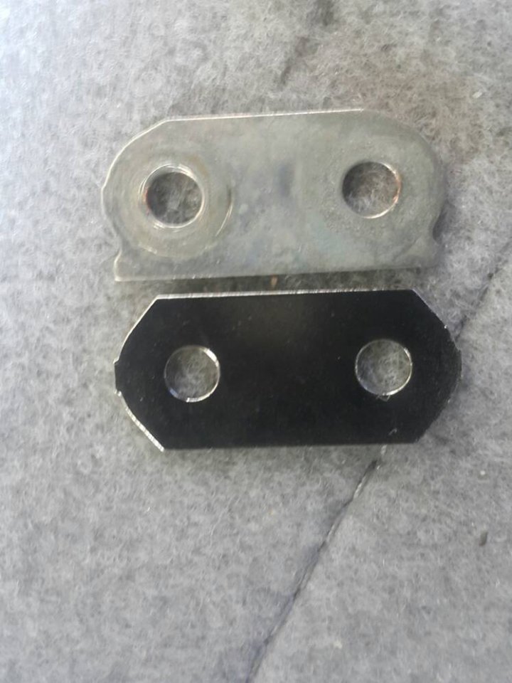

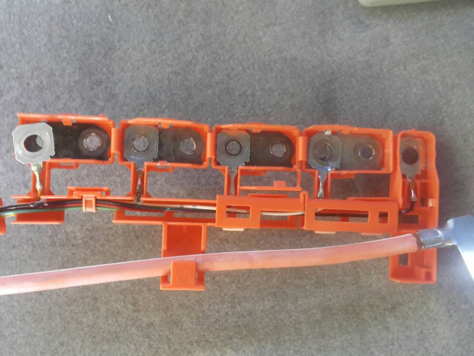

    Installed the new bus bar kit from AcenBay.
    This is kit comes with the correct amount for the Nexcell lithium battery and the price is cheaper than a standard kit.

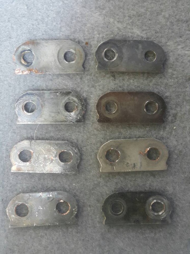

    Below are pictures of my old set that was already installed on the battery when I bought it.
    Also a look at eight of the worst bus bars
    That were being used and a side by side of the old and new bus bars and nuts. 20230429_145411.jpeg 20230429_145404.jpeg 20230429_145357.jpeg 20230429_150356.jpeg 20230429_145730.jpeg 20230429_152044.jpeg 20230429_145512.jpeg 20230506_115154.jpeg 20230429_154011.jpeg
