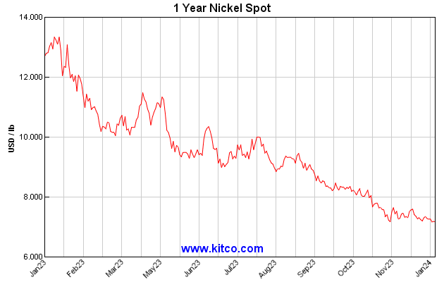

  17. bwilson4web
    28,673
    16,215
    #37 bwilson4web, Apr 12, 2016
    RCO, alanclarkeau and Sillywizard like this.
