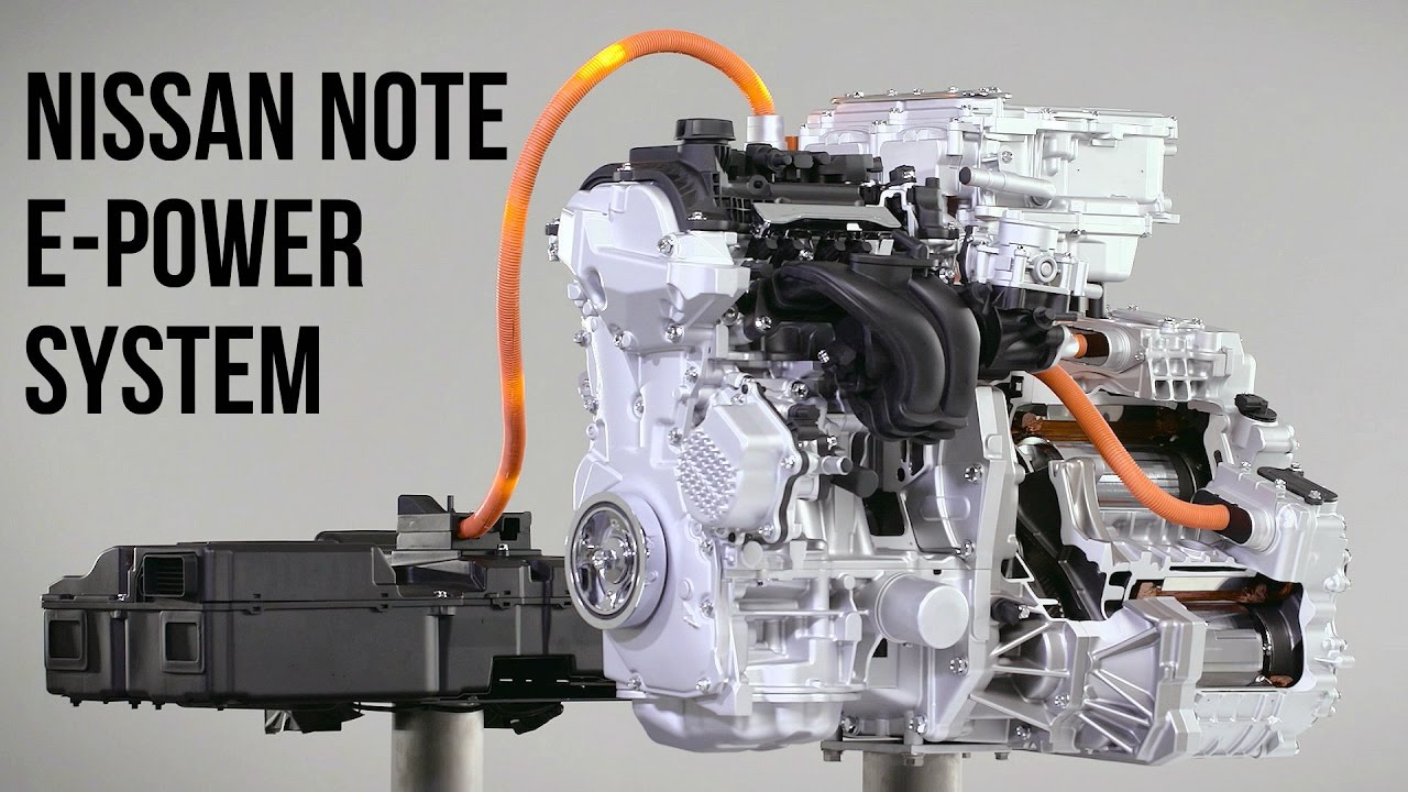

    The Note E-Power has a 58 kW/78 hp engine (at 5400 RPM), and the traction motor produces 80 kW/108 hp. It'll spin that engine up if you need it:
    Seeing how you're only getting about 22 kW from the battery, due to its size, you do need a fair amount of engine power to make up the difference.
    Charging and discharging the battery at the same time is something that's completely nonsensical, and it doesn't actually happen. (It's just that it'll supply power to the traction motor alongside the battery, or the battery may take power from the generator.)
    For long distance trips, the 1.2 should be fine, even if it's not ideal - it's making more power than the 1.5 in the (very much competing) Toyota Aqua/Prius c, and there's plenty of smaller engines asked to do a lot more in forced induction applications. However, that's not what this car has been optimized for - it's optimized for Japanese road conditions, which involve strict 100 km/h/62 mph speed limits, and lots of much slower city operation.
    I don't see a starter motor in any of the overview images of the powertrain, and it wouldn't need one - the generator could be used as one. So, this system is simpler in terms of design and number of components than Toyota's hybrid powertrains - the generator and traction motor have to be bigger, as does the inverter assembly, but there's no actual power split gear set, and the control laws can be simpler (no need to worry about MG1 overrevving, as its speed is directly related to engine speed, without the MG2 speed component).
