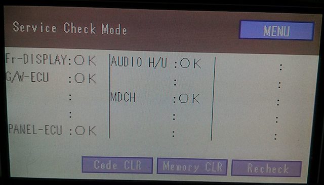

    Occasionally on this forum somebody will stumble on the diagnostic screens in the MFD and get excited hoping they are an alternative to an OBD scanner for engine/powertrain, and I have disappointed them by saying sorry, they only work for diagnosing connections between the audio components, MFD, and nav.
    Thanks for giving me the rare opportunity to say, you know, those MFD diagnostics could be just what you're looking for!
    The "MDCH" on mine is my iPod interface (masquerading as a minidisc changer) so you shouldn't be concerned if it's not on your display. Yours should show a CD player, which I don't have.
    If anything shows other than OK, you can also drill down to specific error codes and post those here (or look them up in the manual at techinfo.toyota.com). This was definitely helpful to me when I was first trying to get the iPod thingy to play nice.

    You get to it from the screen that comes up when you press DISPLAY. I'll just write this quickly but you can find plenty of forum messages more detailed if you need, or of course look it up at techinfo. Ignition on, parking brake on, normal display on. Press DISPLAY. There's a rectangle around most of the screen. Touch six times alternating the top and bottom left corners of the rectangle (TL BL TL BL TL BL). The check screen should come up.
    You can also bring it up with a wire between the TC and CG pins at the DLC3 connector, but if you do it that way it comes up in Japanese. :)
