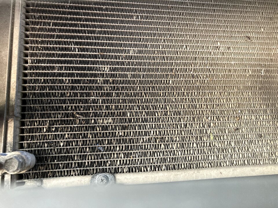

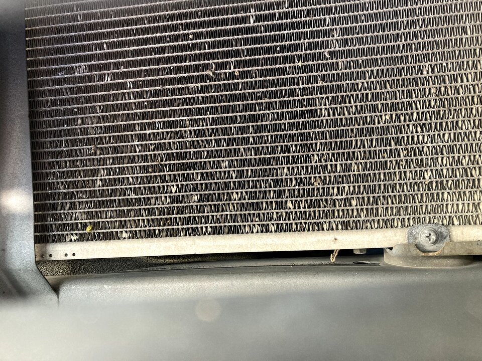

    Hey folks,
    Hoping somebody experienced with Prius matters would be able to provide a suggestion for how to proceed.
    It is really really hot outside right now (90ºF most days). The A/C system on my Prius as not cooling at all. I am unsure of the history of care for the air conditioning, but here's what I can say from an inspection:
    1. Through the sight glass, refrigerant appears to be flowing fine with no bubbles at all.
    2. Console screen HVAC test reports no faults.
    3. Compressor is running (or at least making a loud whirring noise).
    4. Condenser looks... like this (see picture).
    By my understanding, my next course of action should be to follow the steps in [this thread](AC Maintenance | PriusChat) to clean everything. Is it possible that this accounts for all my issues? Is my compressor dirty enough to severely hinder the A/C cooling?

  3. Tombukt2
    Tombukt2 Senior Member
    Nov 29, 2020
    13,864
    2,519
    Durham NC
    Is the fat aluminum hose with a green cap with an L on it getting cool at all ? You're saying no bubbles in the sight glass because it's empty would be a good guess . Most of these leak in the cabin to be clear big costly repair. You could get lucky but it's a stretch. If you push on the Schrader valve marked L do you hear gas escaping . Count one Mississippi. And there's nothing else coming out ? Yep empty . Go wal mart get the big black can w gauge 40 bux . The new version can says hybrid compatible on it . I don't believe it but it says it. Connect this fancy can to the low port fat silver hose . Everything on HI fan and LO cool . Gas her up watching sight glass . Looking cold fat silver hose and a clear or almost clear glass . Add slowly . Once you get to this point and you're making cold look at your watch and note how many hours it takes until it no longer makes cold pay attention
  4. Tombukt2
    Nov 29, 2020
    13,864
    2,519
    Durham NC
    And you're in Texas so either the system's been beat to death and it's going to leak right back out or the last owner did not care about air or the evap core is blown and whole dash is coming out .
  5. nervous_wren
    nervous_wren New Member
    Jun 16, 2026
    Believe it or not it's not empty! I see liquid flowing without bubbles there. My family has been the only owner of this car and I know that most maintenance has been kept up-to-date, but as I said above, I am not sure much has been done with the air conditioning. The L hose is only very slightly cooler than the H hose.
  6. Tombukt2
    Nov 29, 2020
    13,864
    2,519
    Durham NC
    Again take the big stupid black can with the gauge on it and connect it to the low side fat hose all on hi cool no numbers set . What's the gauge on the can say with everything on full tilt? You're looking 36 or do. Psi so whada ya got . I need numbers not you think it's full that rare to actually be so.
