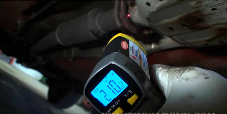

    On the web, you can see a lot of spectacularly ill-informed uses of an IR temp gun. I saw this in a YouTube video once:
    The guy thought he really was measuring the temp of the narrow sliver of exhaust pipe down between the heat shield and flange where he had put the laser spot.

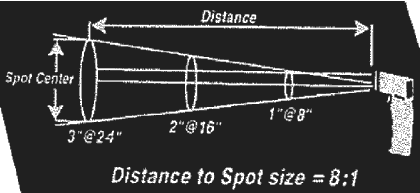

    The tool quite simply doesn't do anything like that at all. It shows you an average temperature over a whole round area whose size depends on the distance from the gun. There should be a chart or drawing like this in its manual somewhere:
    (I cribbed that one from the manual for the exact model of gun being used in that YouTube video ... which the person making the video must never have looked at.) The laser spot is nothing but a rough guide to where the center of the whole measured area is. Some tools have wider or narrower spot size-to-distance ratios, so be sure you know what it is for the one you're using.
    Also, there's the matter of measuring temps off surfaces with different emissivities.
    The tools are handy and fun, but very easy to get fully bogus results with, if not used with enough planning and care.
    One can get clamp-on thermocouples where HVAC service tools are sold, and those eliminate a lot of the slop that comes with an IR gun measurement. (Some IR guns will even have a socket on the side where you can plug a thermocouple in, and then the gun will display the accurate temperature from that.)
