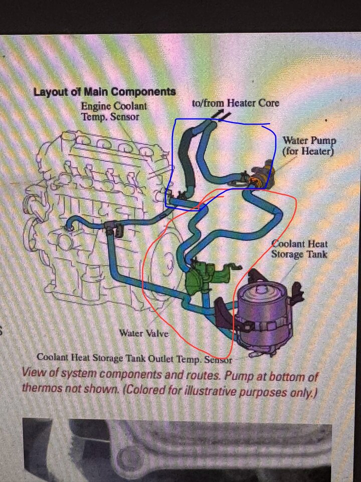

    The red circled hoses are hot, the blue ones are cold when the others are hot. When I switch from face to feet I don’t hear any noises from the blended door moving.

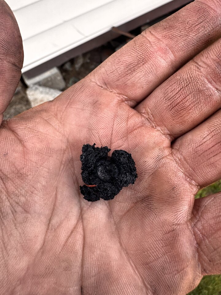

    I have not personally used stop leak or gasket maker on anything and I’ve owned the vehicle for many yrs now, the second picture is what clogged the heat water pump blowing in the lines air moves freely though the system

    Sounds like a blockage somewhere between the electric water pump (inside the blue circle) and the T intersection of hoses in front of the engine. It wouldn't matter where in that section was blocked, any position would stop coolant flow through the entire section, and heat wouldn't move either, except a little by diffusion from the ends. Perhaps try flushing water through that entire section. Clamp the coolant hose upstream of the water pump and the two other hoses at the T intersection, then detach the 3rd hose at the T intersection and the hose downstream at the water pump. Maybe best to flush it in the opposite direction first - in at the T hose and out at the water pump hose.
    Is that black thing in the second picture squishy? It looks like a ripped up chunk of coolant hose. If that is what it is changing all of the cooling hoses may be in your future.

    The internal channels of the heater radiator are relatively thin. When such a piece of rubber gets into the heater radiator, it will clog the hole and the movement of liquid will stop. It is necessary to disconnect the tubes from the heater core at the top in the picture and try to flush them.

    Well it seems pretty darn obvious to me!!! According to your attachments - the coolant hoses going to and from your heater core are COLD; why would you get cabin heat; if they're cold - magic???? Stop troubleshooting blend door issues and get hot coolant flowing through those hoses.

    Flushed the heater core yesterday and got some chunks of black foam out then used an air hose and blew the water out, then filled the heater core with antifreeze and attached the hoses again added more coolant and switched from heat to cold ac then back to heat. I know have cold ac and hot heat
