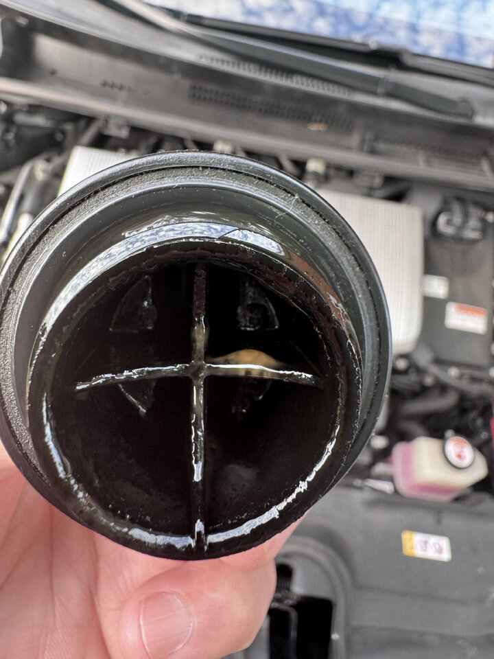

    My symptoms on my 2019:
    -Billowing white smoke upon starting in maintenance mode yesterday morning
    -using about 2-3 of coolant each morning (refilling from the loss each day)
    -snot mix on the inside of the oil
    filler cap (I already cleaned it last week)

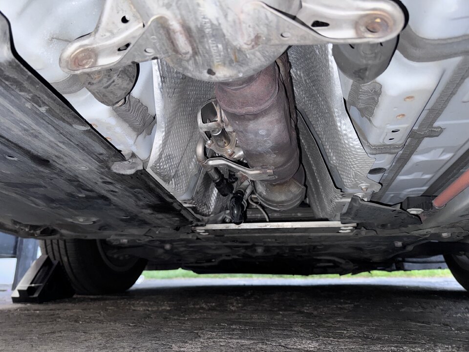

    -rule out head exchanger, I bypassed that almost immediately after buying it.
    Sure seems head gaskety. Not sure how or why it happened. It did happen after my first “big trip”- 600 miles up to Baltimore, back through the WV mountains. I did feel like sometimes I was going straight up a steep incline for 10 miles lol- maybe I pushed her too hard.
    I just bought it. Had 205000 miles on it.

    Was the exhaust heat exchanger leaking? Maybe previous owner had neglected coolant top-up, let the engine run dry a time or two, led to head gasket failure. That’s been reported here before.

    Even after I bypassed the heat exchanger (and I did it under the car), you are stating there is still a way for the coolant to be leaking into the exhaust? IMG_4512.jpg

    Sequence that does make sense, assuming the EHR system did have a leak:
    1. EHR system commences leaking.
    2. Owner doesn't notice for some time, belatedly tops up coolant, but by then engine's run dry a time or two, overheated, and head gasket commences to leak coolant into combustion chambers.
    3. EHR system is bypassed, but head gasket continues to leak.

    Just technical: is there an arched/ribbed face of the wheel chock against the ground, and flat face against the tire? If so, think it should be flipped:

    I don't think that oil cap looks that bad. It's probably not after you did your big road trip. And on Gen3's the oil rarely gets into the oil. It just seeps into the #1 or 2 cylinders after shut down. This I know, a few times.....:(

    The wheel chock is facing correctly

    Are you sure all coolant hoses are removed from the EHR parts near the CAT?
