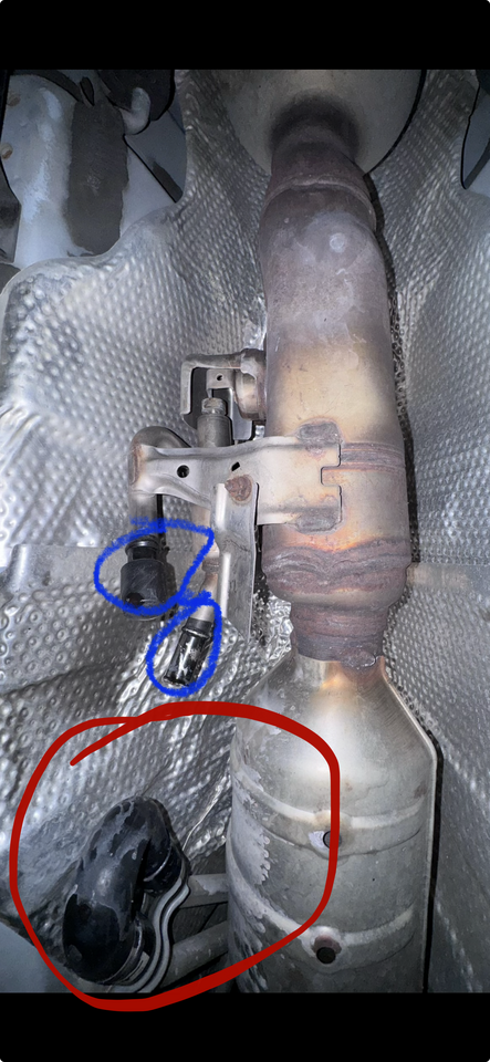

    As far as the coolant hoses that I bypassed- I have a picture up there. How else does the coolant enter the exhaust? I’m asking because I don’t know.

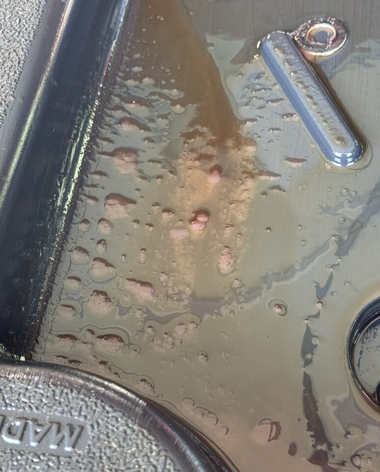

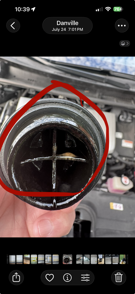

    • Estimating (loses about 8 oz of coolant a day)
    • Only really notice the white smoke if I start in maintenance mode (otherwise I'm driving). Haven't really noticed it from a start at a red light, etc.

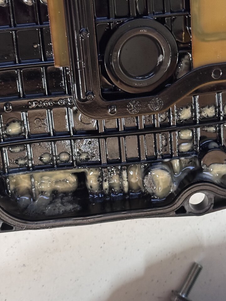

    • See a snotty, milky substance in the oil cap

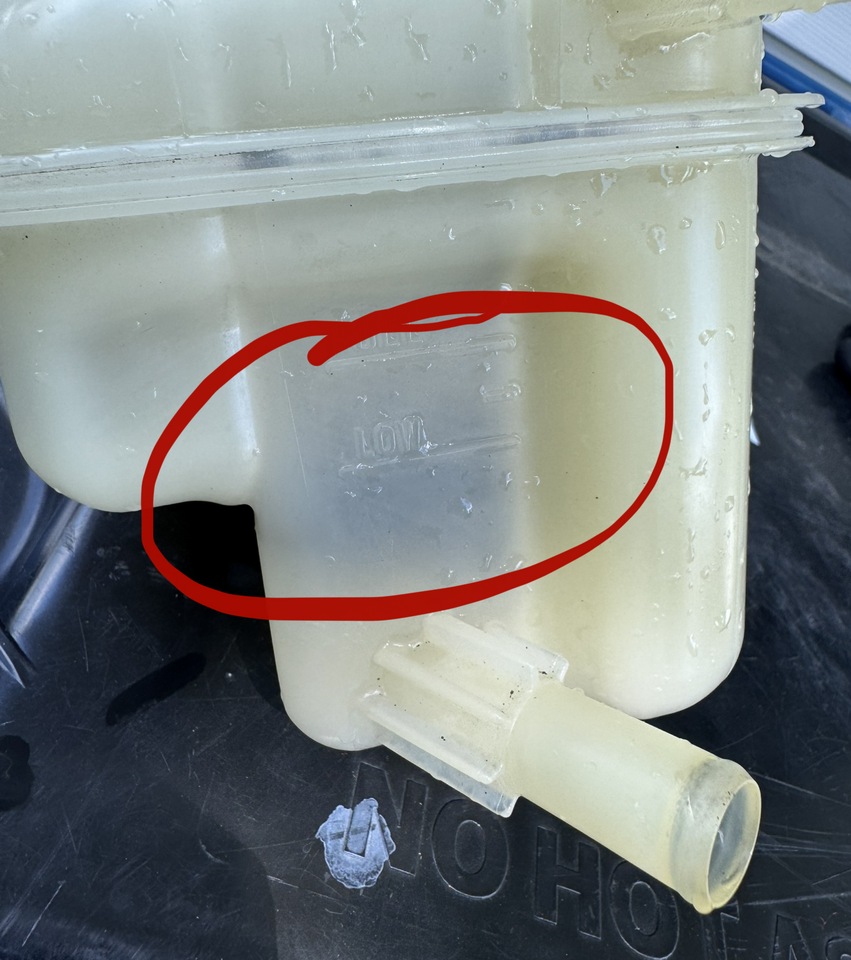

    • I think I spot some carbon in the coolant reservoir. See photo. I noticed this really bad in my last gen 3.
    • Never a check engine light, I just use "Car Scanner App". I have had an occasional inactive misfire code, and an occasional P148F code.
    • I bypassed the Heat Exchanger almost as soon as bought it 15,000 miles ago. I could smell and see coolant coming out the exhaust. I bypassed it at the bottom.

    It’s definitely coming out of the weep hole at the top of the reservoir. And I feel like in the cabin, you can smell coolant a couple of minutes after you start off on your drive to work-the conditions are that maybe you get the RPMs up to 3500-4000 and that’s when it occurs I’m guessing. You can’t really duplicate that in maintenance mode, it seems to top off around 2000-2400 if I recall correctly.

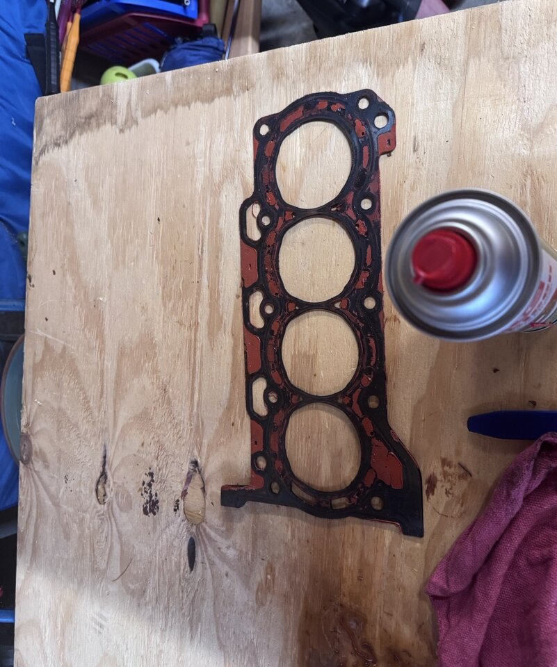

    IMG_0491.jpeg IMG_0495.jpeg IMG_0494.jpeg She definitely needed a head gasket. It’s the same engine as the gen 3, using the same Felpro gasket as I used on the others I did this year.
    I’m in the middle of this and it is raining, so I am on break. I have a couple of thoughts here:
    1.Ive always thought the engine looked “new”, specifically all hoses, water pumps, everything you can see. However, when I get into the engine more- it looks kind of chalky on the surface. I’m wondering if someone didn’t do an engine swap. Which…if they did, makes you wonder about the argument about head gasket vs engine swap. For my labor costs- I’ll do head gasket
    2. The head gasket has a red material that was all over it and the surfaces. Previous head gaskets I changed were black. Wonder what type of head gasket this is?
    If it’s not on the CARFAX, there’s really no way to tell if an engine swap has been done is there?
    Also- somehow my searches had been missing a good head gasket video for this generation by Gasketmasters. It’s a good reference if you have nothing else, but they go kind of quick. Nothing like the awesome video from NutsAboutBoltz for the Gen3.
    In this experience, I can confirm that the Gen 4 EGR cooler issue does appear to be solved- there is no carbon clog here that needs to be addressed.
