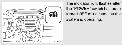

    Say what? That light blinks all the time when the car is off. Car antitheft systems have been like that for ages. It's the "hey thief, go steal some other car, this one's got a blinking light" light. (They were probably more effective back in the early days, when not every car in sight had its own blinking light on the dash.)
    That's from a gen 3 liftback owners' manual, but you get the idea.
    It's funny how many conversations I've had even IRL with people who have had a car for years and never noticed that light blinking till yesterday, then cannot be told it was doing that all along, and insist it only just started.

    Sorry, let me rephrase - It shouldn't be lit, if it recognizes your key/FOB. @ChapmanF - Yes it does flash when active, which is whenever it doesn't see the key/FOB. We never notice it because when we unlock and jump into the car, it's usually OFF. If the fob battery is dead or near dead, you may still see the lockout flashing - so you need to do the dead fob startup routine.

    I checked it with a friend who has the same Prius and this light flashes until you start the car
