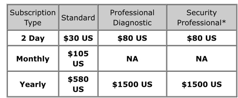

    My understanding is when you don't have a working fob, it requires a licensed locksmith listed as a current member of the NASTF Vehicle "Security Professional" Registry.
    On top of that, the traditional Techstream won't work in the clear all old situation, you have to buy a "Security Professional" access from Toyota TIS, minimum $80 for 2 days and download the completely new GTS+ Global Techstream+ software.
    Of course, its much easier if you are simply adding a fob when you have a working fob. Which is a good reason not to rely on one working fob which might be lost or could fail.
    It's not clear to me if the security is the same on a gen2 but it is likely.
    I know one locksmith near me can do it but he had to get the new Toyota software.
    If you have more than one dealer, price shop.
    BiomedO1 likes this.
