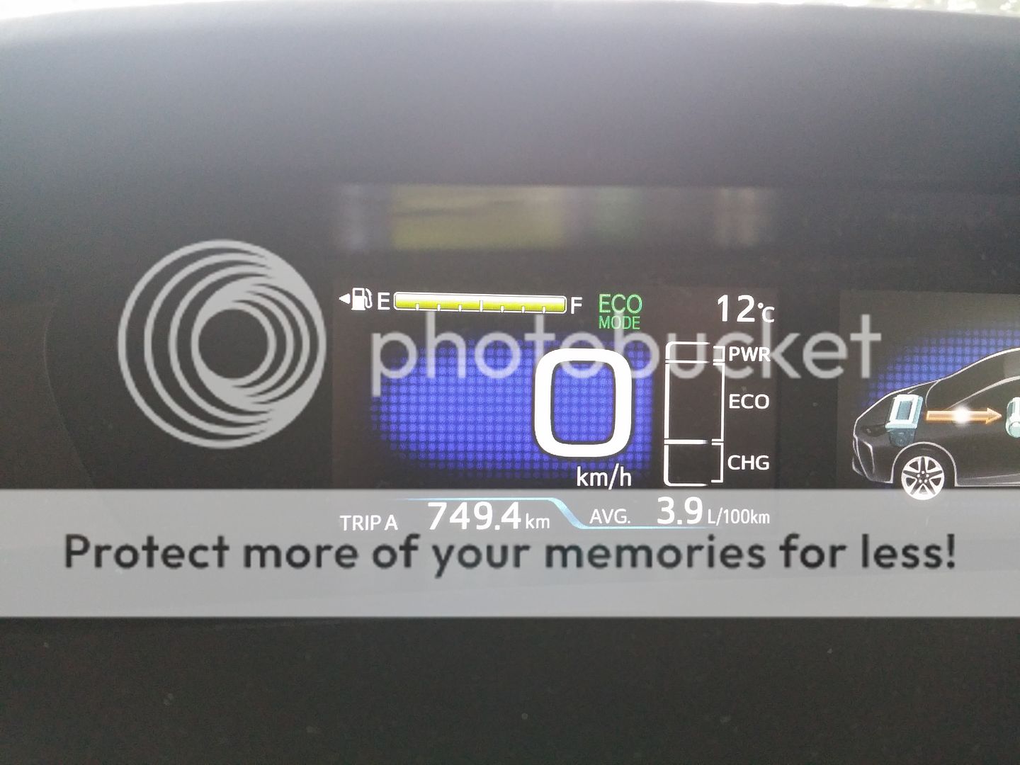

    Actually, I am trying pretty hard to get good mileage; I looked up videos of how to drive a Prius, as I've never had one before now :)
    So far mine's 0.1-0.2L/100kms optimistic, but I'm waiting for at least ten tanks to call the average error of the dash readout.
    My last tank, which on the spreadsheet showed 4.0/100, showed 3.9 on the dash:

    I turn off the lane detection beep, as I commute over a twisty mountain pass, and it'd beep all the time. Yes, the side hinge console lid is annoying :) I find that the sliders on the sun visors do a decent job. I hate where the heated-seat switches were moved to for 2019.
    My tenth tank got an average of 3.8L/100kms (61.9 us mpg) by the spreadsheet, and that's with awd. I'm damn happy :)
    My dash seems to be 0.2L/100kms -- 3mpg -- optimistic; I wish that could be adjusted.
