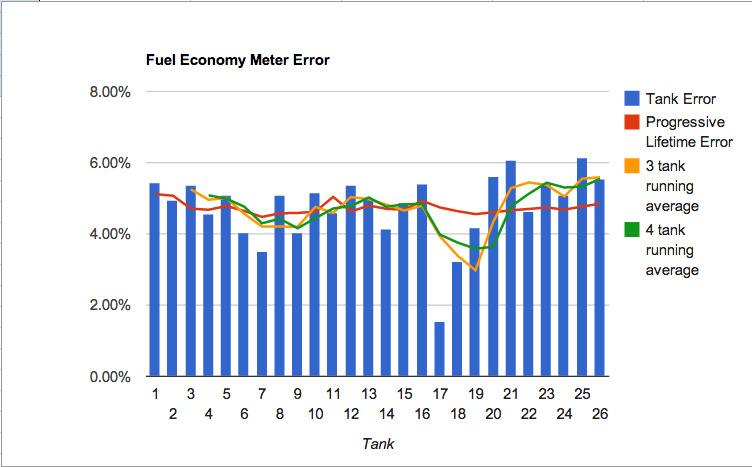

    I kept track of some 25 consecutive tanks in my Lexus CTh -- a Prius twin:
    Average error is 5.02%, SD is 1.22%
    Jonny Zero likes this.

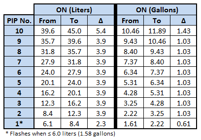

    Here's my handy-dandy PIP chart:
