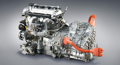

    I'm not sure what you mean by tranny, this is a tranny
    The Prius has something looks more like this
    under the bonnet.

    That looks more like a Transaxle...
