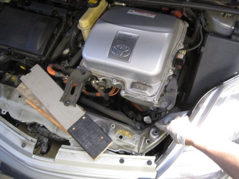

  11. Mendel Leisk
    60,340
    41,516
    Apologies for being off-topic, wrong gen, but maybe someone can comment: this cannot be necessary??
    Huh, maybe:
    Still, I'd look for a work around. Toyota seems to come from the remove your pants to take a pee school of thought.
    #31 Mendel Leisk, Jul 11, 2018

  12. JC91006
    JC91006 Senior Member
    Nov 10, 2013
    16,769
    8,567
    This removal of inverter is necessary only to make room. If you can get around not doing that, then it's not a necessary step.
    Just like the advise you to remove the front bumper to change a headlight bulb. It's really not necessary
    Raytheeagle likes this.

    2019 Prius Prime
    We changed the inverter pump on @SFO ’s 2007 with only loosening the inverter, leaving the headlight as is and were able to get to the pump and swap it;).
    Really not a bad job(y).
    #33 Raytheeagle, Jul 11, 2018
  14. SFO
    SFO Senior Member
    Feb 7, 2017
    5,302
    4,249
    Northern California
    We took out the front bolt and propped up the inverter an inch or so, was still a tight fit.
    (example image below, not my hand pointing at the wrong part in question)

  15. JC91006
    Nov 10, 2013
    16,769
    8,567
    Why do it the hard way? Bumper headlight removal takes 5 minutes
  16. Raytheeagle
    Raytheeagle Senior Member
    Jul 1, 2016
    11,265
    15,520
    Bay Area, California
    2019 Prius Prime
    Hard :whistle:?
    It still took all of about an hour total;).
    But we were shooting the breeze while doing the job:).
    Good suggestion though (y).
